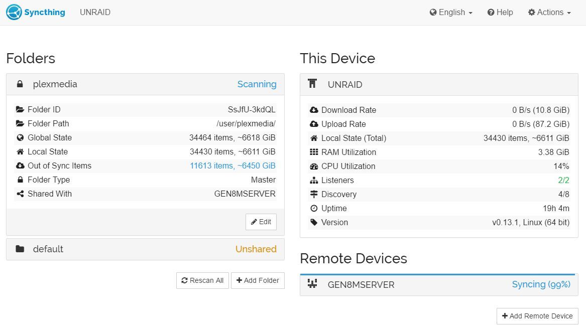

Sorry to be a pain but it finished scanning a 4-5 hours ago the percentage went to 100% and then it changed to just “scanning” and is still sat there like that? it is not syncing any new files, what is it doing now?
Many Thanks
Picture attached
My best guess it’s that it’s reconciling it’s view of the repo with the other side, which can probably take a while given the size. You might want to change the scanning frequency to something way higher than a minute as well…

Let me amend that. 34k files really isn’t that many, so the periodic scan should be quite fast - less than a second if the metadata is in disk cache. However 6618 GB is a shitload of blocks which makes a lot of database operations and the index exchange heavy. You can probably expect some sluggish performance all around. Stay tuned for a future version with variable block size better tuned for handling many largeish files.
