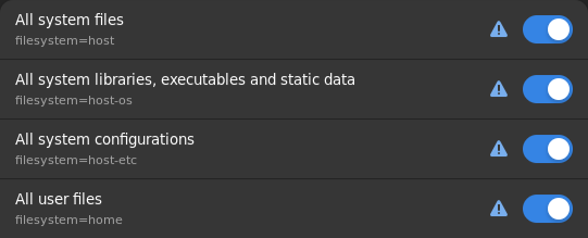

There’s nothing wrong with trying and using different methods that end up with the same result, but it’s often best to stick with a single approach until after getting more comfortable with it.
Since it’s easier and faster to show how to use the stock flatpak
command than to describe using a GUI app such as Flatseal, I’m sticking with the command-line.

(I have nothing against Flatseal and think it’s a convenient tool, but I also think it’s well worth first learning how to use the flatpak
command because it helps build a good foundation for understanding exactly what Flatseal is doing behind the scenes.)
