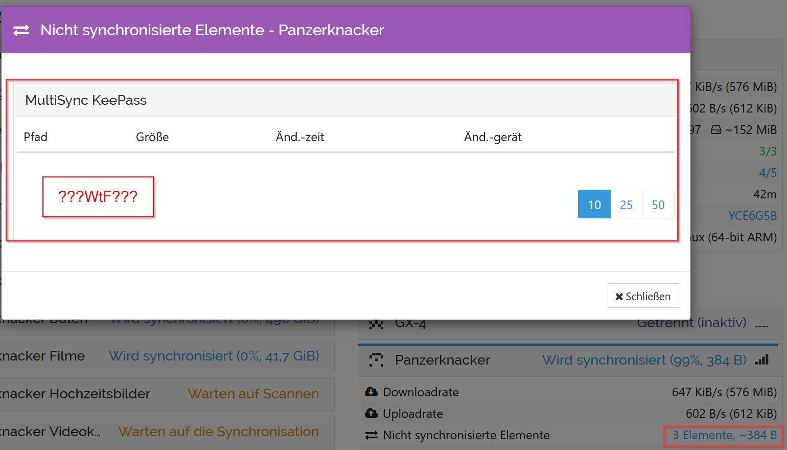

Nameless non synchronized files
I see a strange effect: In this example there are three files displayed as unsynchronized (but in fact never will be synchronized, the progress keeps being frozen at 99%!), clicking on them only shows an empty list:
What is wrong here? And how to complete the progress and to determine what files are affected?

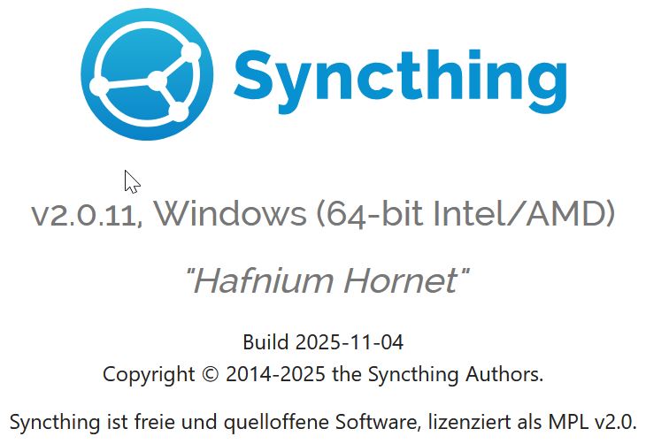

Syncthing Version is this:
This is a known bug with no solution yet. You can try pausing folders one by one first, so that you know which one is the culprit. You could then remove and re-add the affected folder (just within Syncthing), which should get rid of the invisible items.
I think we’re just missing a progress spinner and the items haven’t loaded yet
That does happen sometimes, but with just 3 items (and probably folders, judging by the size), I think it’s likely
I think it’s just a non-optimised/indexed query that is O(folder size) rather than O(number of out of sync items), and that the issue is effectively just lack of patience. (Perhaps justifiably so depending on how long it actually takes.)
I don’t think so! The problem persists here since at least(!!) 2 days unchanged. Way too long, also for the extra-patient :slight_smile:

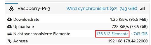

I hardly believe this is limited to just 3 items! Here is an example with distinctively more:

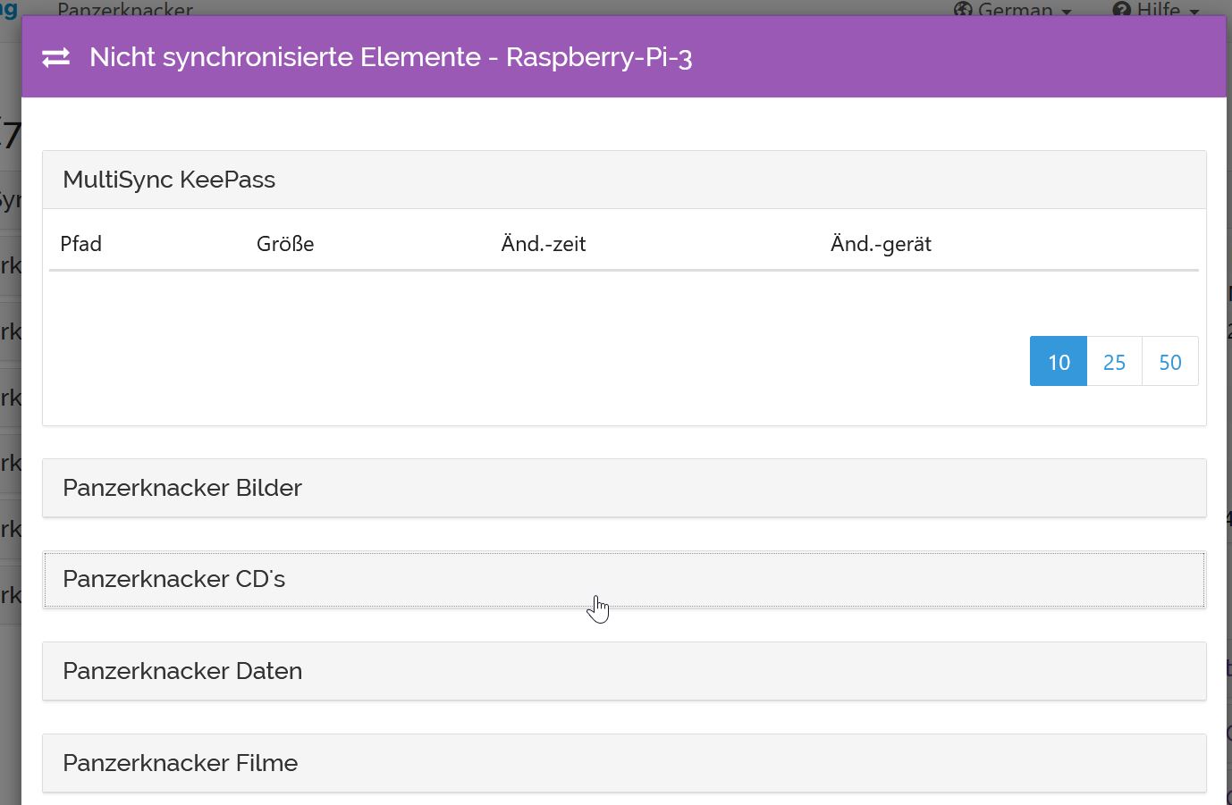

Empty (believe me. Whatever I unfold)

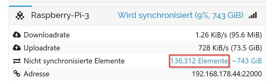

Really, really, many items:
