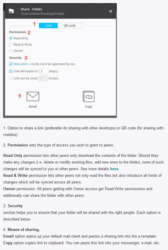

I also think it’s good to build on security and to put trust in the center. Nevertheless, I find the attitude mentioned somewhat stuck. If I want to share a peer, I can arrange the sharing in such a way that I can influence data security, e.g .:
If I were to spread it more broadly, I would set up: Read only, time-limited and with a password, which I could change myself, this would be necessary.
Sorry, but it’s not clear to me what you are trying to say
In my opinion, a invert to a trust model is not necessary with such features. I can ensure my data security by using such options as shown.
Not the way it’s implemented now. Now everything is based around devices, not folders. In your screenshot, most stuff revolves around folders, not devices.
Also, the features you show in the screenshot are already inverted, suddenly there is an “owner” of data in a decentralised system.
