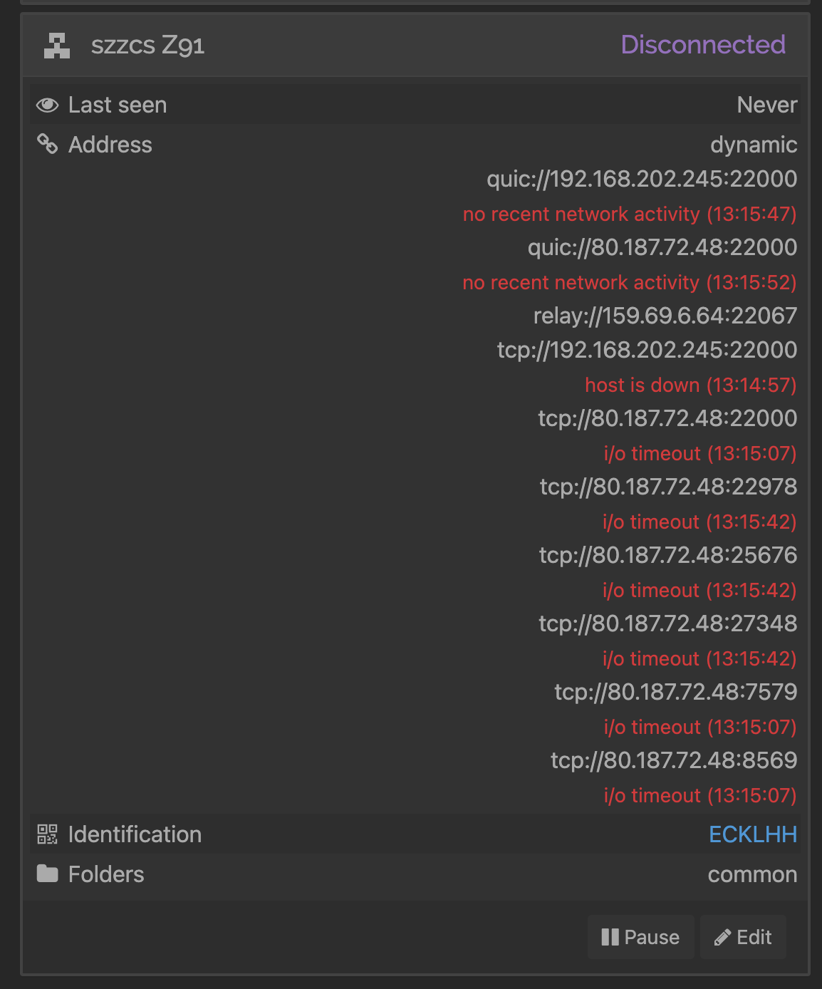

Today I have added a new Android device, both, global and local discovery are enabled, both devices are added to each other, same network, no connection.
it says “no recent network activity”:
On this device I don’t use multiple user profiles.
After that, I enabled NAT Traversal and Relaying on both ends, waited 5 minutes and it suddenly works and both devices found each other. Something is broke.
