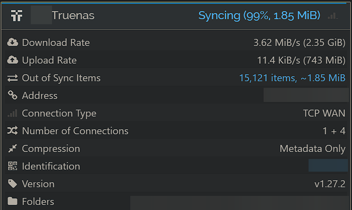

Hi I have 2 syncthing boxes that share a particular folder. On source side it has 85k folders while on the encrypted receiving side it has 70k folders.
Total size roughly matches up but the source complains that it has 15k folders out of sync that weigh 128kb each and around 1.85mb in total but it doesn’t sync them. The receiving side shows as Up to Date for this folder.

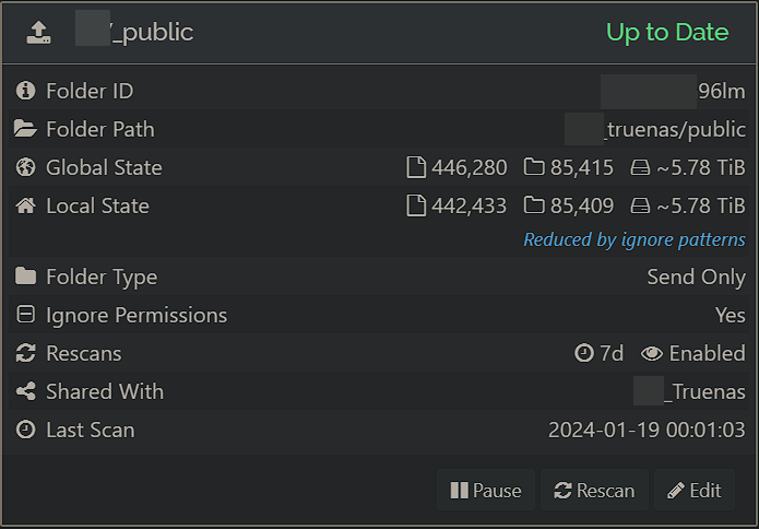

Source:

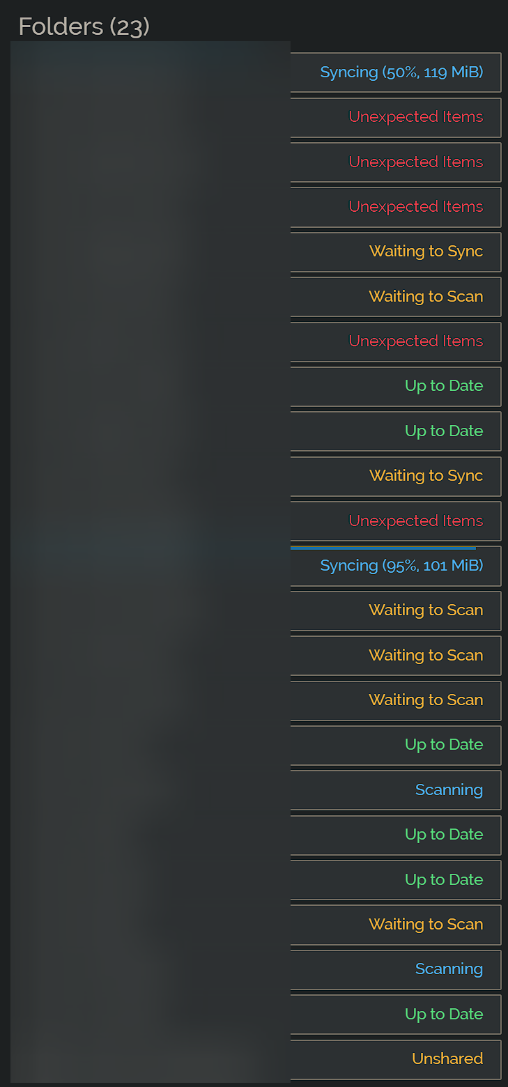

Receiving side: image

What does Syncthing say when you click on the “15,121 items, ~1.85 MiB” link?

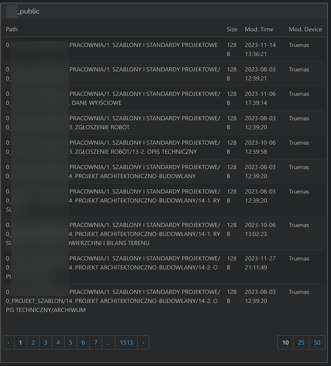

It shows a list of 128b folders. I’ve checked a few of them and they do have normal files inside them so they should sync normally, they are not empty (well at least the ones on the first page, I’m not going to manually check 15k folders.
A little too much was redacted in the images to be certain which box is which, but the next step would be to hover a mouse pointer over one of the out of sync files in the pop-up to see what Syncthing says about the file.

There are 4 screenshots in the first post, 2 for source and 2 for receiving side. First one in both after the colon is a Folder box on the left side in syncthing, while second one is the device side on the right side in syncthing.
I hovered over the files and nothing pops up.

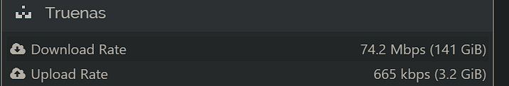

So this is completely wrong. I just tried it and it absolutely does resync everything. I’ve changed none of the files and yet it started downloading over 140gb just after starting with a new database. Now here is hoping that restoring the database doesn’t destroy things further.

It absolutely did start resyncing files. I saw 140gb of traffic going between routers and I can see it in Syncthing stats. 140gb of data is not “comparisions”
