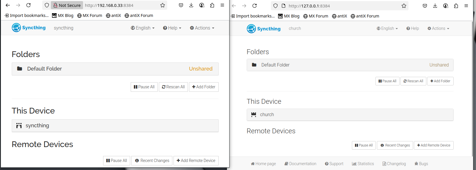

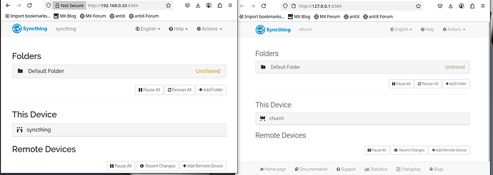

Thanks for the response. As built by me: Asustor Nas, open media vault installed on emmc, docker, syncthing. Workstations have fresh install of debian, syncthing is running and some syncs are good, the workstation in the office with the nas is supposed to sync 400gb of files but sync would have taken over a 1000 hours. It was relaying on wan even though everything is 192.168.0.xxx on this lan. Screenshot shows “syncthing” has somehow replaced “nastradamas” which is my nas and main SSD and will have everything once dekstop syncs with it. This started after trying to fix the slow transfer, same user and password brought up “syncthing” instead of “nas” at the OMV/sycnthing/nas device. FYI, this is absolutely overwhelming my ability, editing config.xml files have failed.
Brought the “church” computer to office and you can see thats its relaying even
though on same switch as the nas.

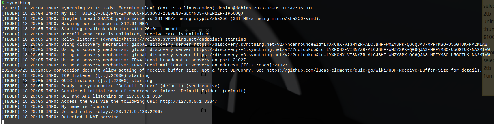

Yeah, so you likely do need to fiddle with the firewall, etc. to make Syncthing establish direct connections, as otherwise synchronising that many files is going to take a long time. Also, I would suggest to switch your Syncthing packages to https://apt.syncthing.net, as right now, it seems that you’re using what Debian provides, and those are heavily outdated Syncthing versions.
