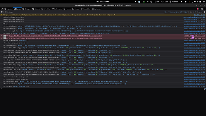

i dont understand this issue at all, it happens so inconsistently. so far ive had this happen between multiple different networks (at home and at other networks) and after some specific actions (waking after suspend) but trying to replicate it myself yields nothing as it will fix itself suddenly and never trigger again until it decides to break on me and trying to test this issue on different networks will be quite difficult. systemctl shows that its doing fine, the ps command you guys sent doesnt show anything too unusual, i am completely lost on this issue. here is a screenshot of firefox’s dev console that i took just now after i woke this thing up from suspend.

systemd’s status output in those two screenshots look fine.
The only notable thing is that your “Main ASUS” machine is behind a CGNAT, so getting two Syncthing devices connected can sometimes be a bit trickier with that kind of setup (if you ever run into the problem, search this forum for “CGNAT”).
