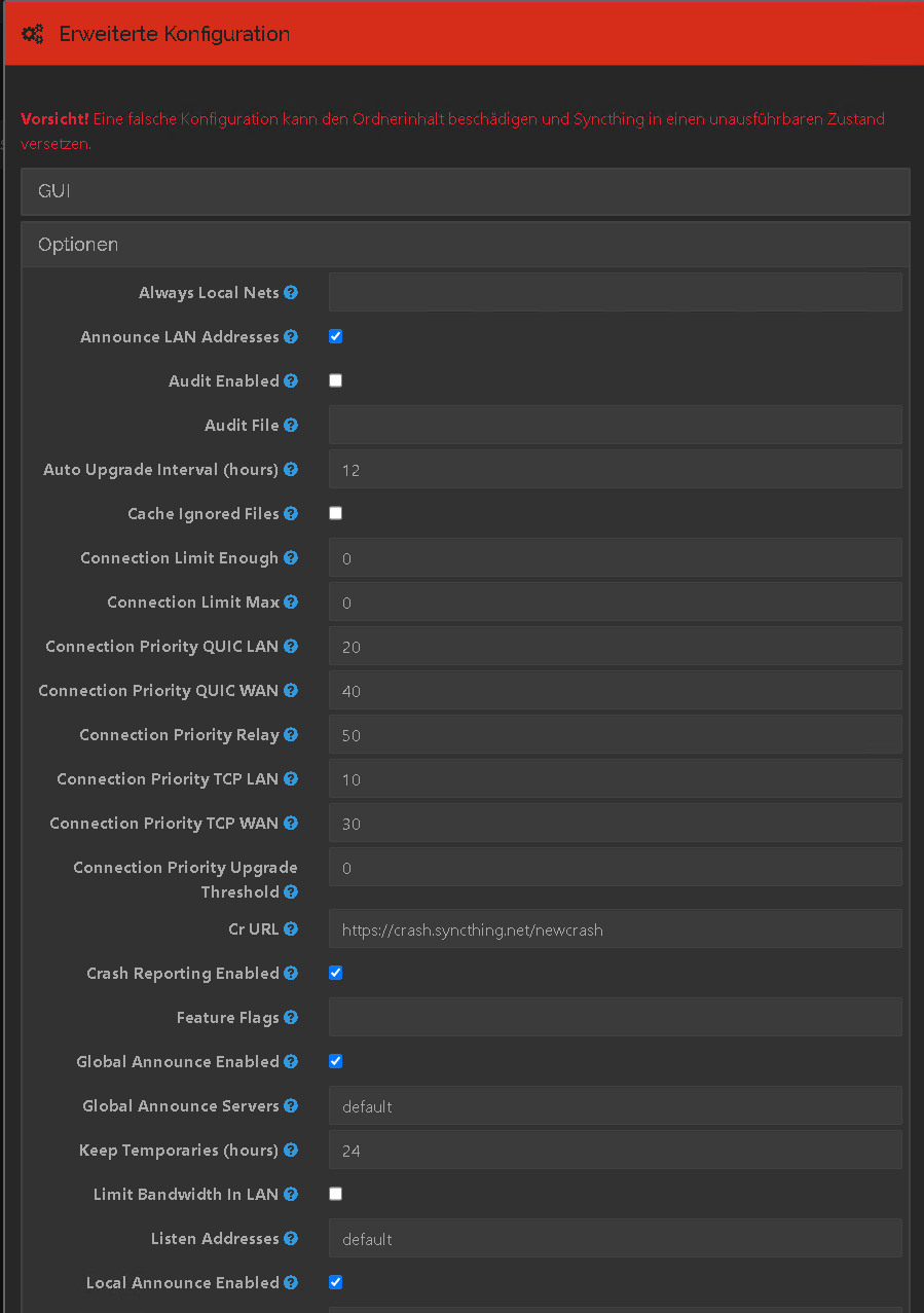

Are you guys sure, that values e.g. like 1,5 is allowed for Fs Watcher Delay (seconds) ?
Yes, but with a dot, e.g. 1.5. The main use case is to set it to very small values like 0.1 for instantaneous sync.
As programmer i was trying with dot but it return back to comma o.O
Can you share a screenshot?
