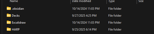

I am not even syncing that file from my vault.
That folder sits on the same level of my vault contents and I am syncing only those contents.
Below is an image of my vault and I am only syncing the HARP folder and all of it’s contents.
