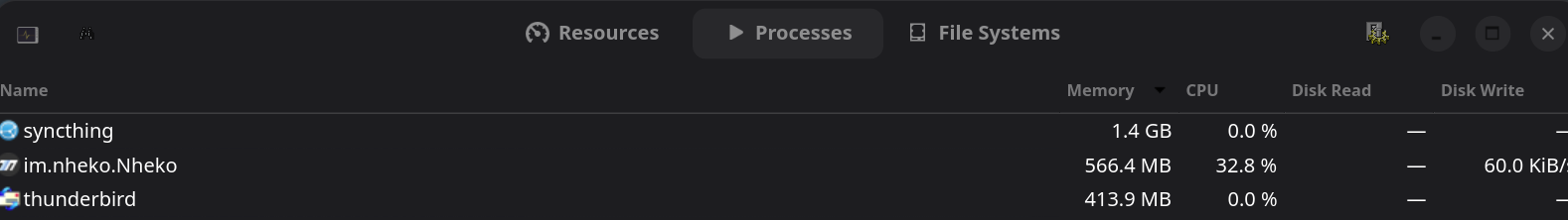

Is there a recommended way to work with syncthing’s memory requirements? They seem to be pretty high on some of my Linux machines:
It uses less on some of my others, I’m not sure yet why. The amount of folders I’m synchronizing is admittedly fairly large, but they don’t change much, if that somehow helps with advice for my use case.
