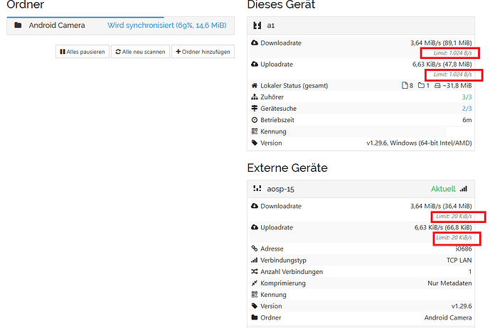

During my current dev session I’ve noticed that my rate limits do not apply. I’m using then intentionally on a relay connection between PC and test virtual android device to slow down the sync process and analyze the events coming in while that’s happening. But my sync experience is fast, please compare to the rate shown on the Web UI, it’s waaaay faster than configured. Is that a bug? The rate limits are set on both sides, PC and virtual Android. This is a test setup, so only that two devices and the public relay is in place.

The connection type is shown as “TCP LAN”, so no relay involved here. Rate limits do not apply to LAN connections by default (though there’s an advanced config option for that).
Ah okay, somehow the emulator managed to get a local connection. :slight_smile: Thanks for clarifying.
