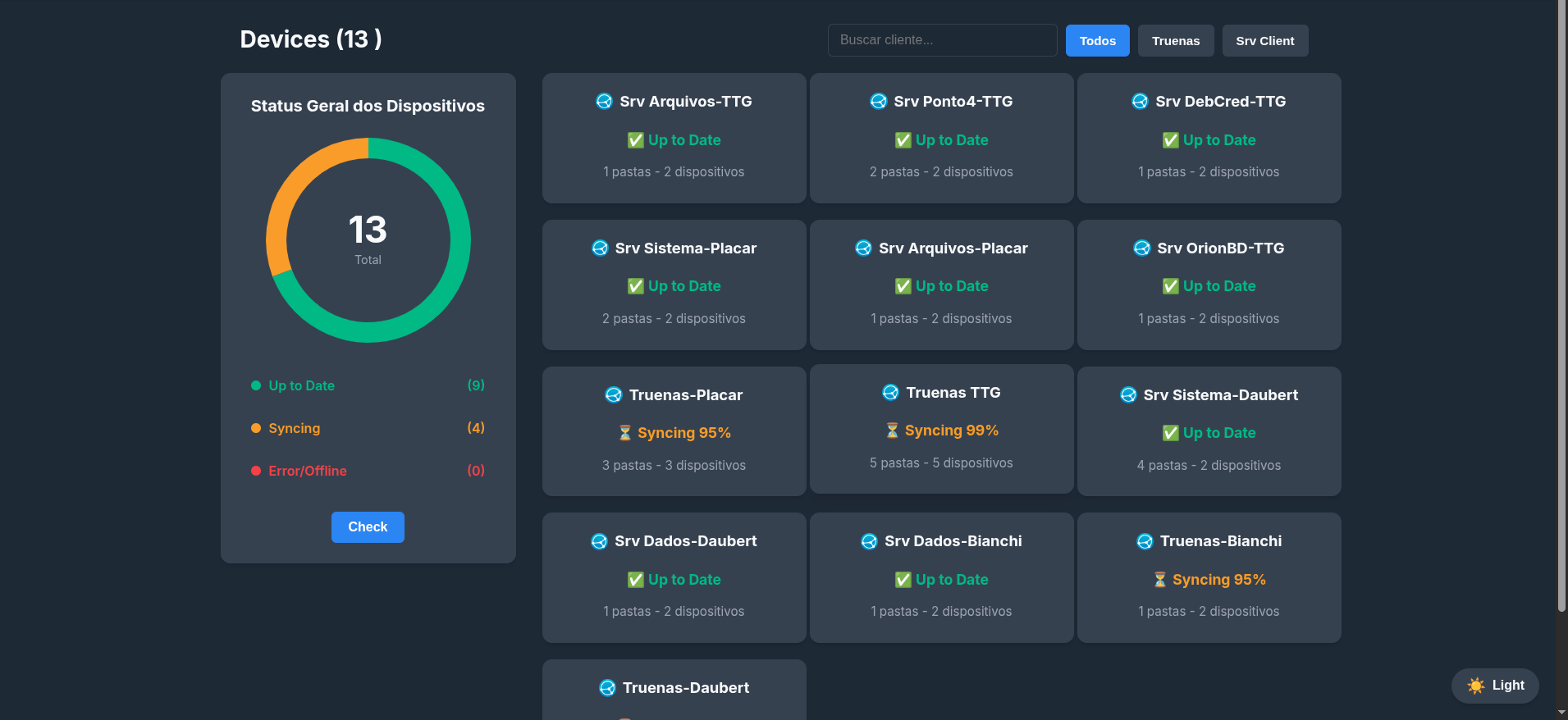

Man, thank you so much! I’d been looking for a project like this to monitor my clients’ devices where Syncthing is installed. I took your project as a base and made a few modifications — one of them was adding a chart to make it look more professional. Thanks again, you’re the man!
I’ve seen none off those problems myself. Nothing seems to have changed to the api for what sm2 uses. I know my response is late but do you still have these issues?
Feel free to make a pull request with your improvements.
