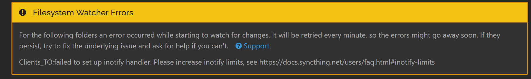

Receive the “failed to set up inotify handler. Please increase inotify limits, see FAQ — Syncthing documentation
This is version 2.0.3. I have followed the link and done that task. I have 3 shared folders – only indicates 1 of the folders, and its is the largest one (about 320k items).
I followed another suggestion to increase the number even more (I think it was 409600) and that still did not work.
I can not find any suggestions that are not 7-8 years old.
System is a Debian 13 vm with 2 cores and 2GB RAM. Ive looked at the resources being used, and its only using about 40-50% of the RAM. I know iNotify is memory sensitive, but I dont feel like an increase is the answer (?).

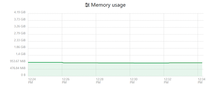

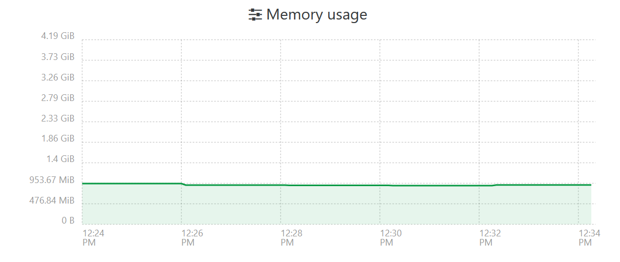

Same results all. For record:
Command - sudo echo “fs.inotify.max_user_watches=2048000” | sudo tee -a /etc/sysctl.conf (rebooting after running the command)
Ram Usage (4GB):
On the right track – approximately 1GB of RAM per 1 million watches.
