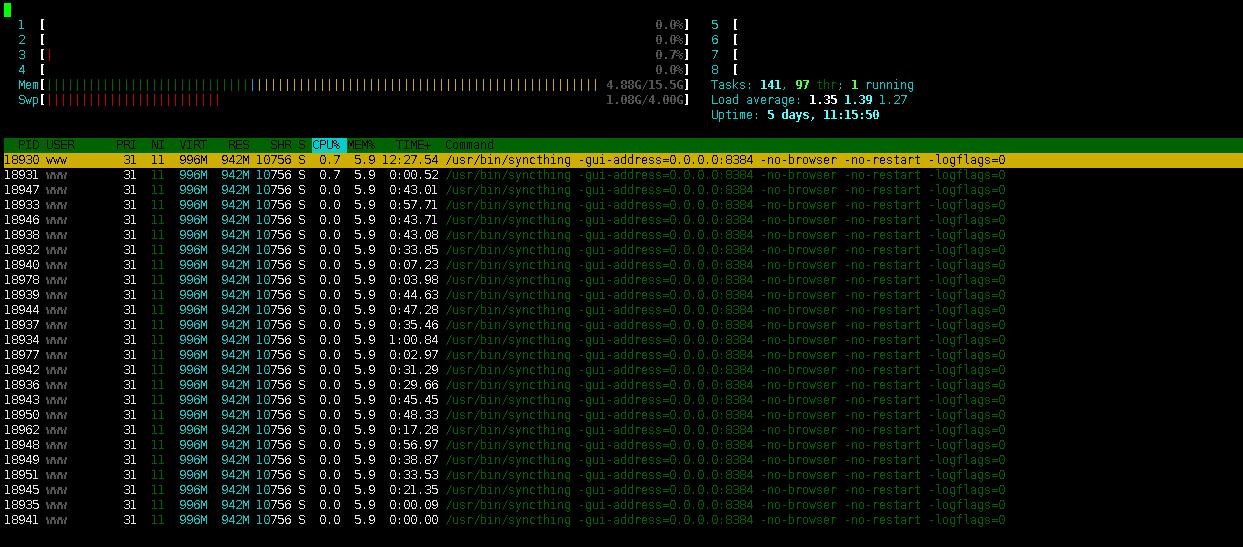

I need to sync the files of this windows server to linux!
After I added the task, this task has been in the scan! It has been 2 days!
When scanning, the memory usage is very high, and even all the memory is full!
In the past two days, syncthing has performed an automatic restart at least 3 times!
Is this normal?
The above problem is not well solved, and I have no time to study it!
My new approach is that I compress 40 million files RAR into one file and transfer it to a new server with 16G memory.
This 16G server also has syncthing installed, and an empty folder as a synchronous use folder (folder type: send only), and selected “Watch for Changes”, and then syncthing client with the backup server " Folder type: Receive only "modes for simultaneous connections!
The “progressUpdateIntervalS” and “ScanProgressIntervalS” configurations of both servers are both “-1”
After the above setup is complete, unzip the RAR archive in this new folder!
The 16G server successfully detected the 15315 files for the first time and successfully synchronized to the backup server!
Question one:
After the synchronization is completed, “syncthing” does not continue to perform the task. The 16G server does not detect the new file increase, and always displays 15315 files!
I paused to understand compression and also did not detect the addition of new files!
At this time, 4 million files should have been unpacked!
The above is the first question!
After I pause the decompression, manually manipulate the folder’s “Rescan” button, the number of new files is successfully increased and synchronized to the backup server;
Question 2:
The backup server prompts the following error during this synchronization:
And the “syncthing” service of the backup server is frequently restarted. The longest “uptime” is 15 minutes, and then it is restarted!

This is only the logging of the “events” level!
Last record of a few seconds before the service is restarted
Unable to send too long records, some were intercepted and deleted

Synching has a lot of running processes, is this normal?
You are probably seeing threads not processes, as they all have exact same memory.
When you start seeing errors can you as root run ‘ls -lah /proc/[pid of syncthing]/fd’.
I suspect you need to raise the open file limit for the user running syncthing as guess ulimit -a will show that you are limited to 1024 files, which is quite low.
Also, quote your logs in triple backtick ""` to have sensible formatting.
