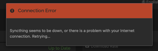

While watching the process unfold on both computer screens, all was going as expected when in the middle of the process the syncing stopped. An error appeared on the Mac Pro where I was initiating the work. An error alert appeared on that machine…
“SyncThing seems to be down, or there is a problem with your Internet connection Retrying…”

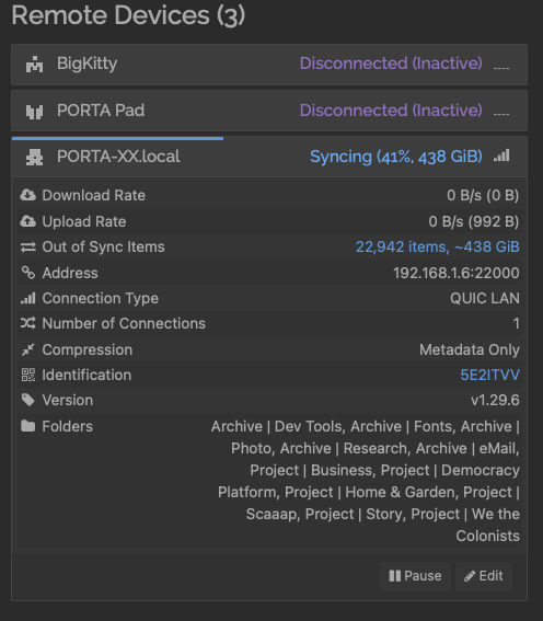

On the Mac Pro, where the remote devices are shown the MacBook Pro is listed as disconnected but it will then show it is attempting to sync…

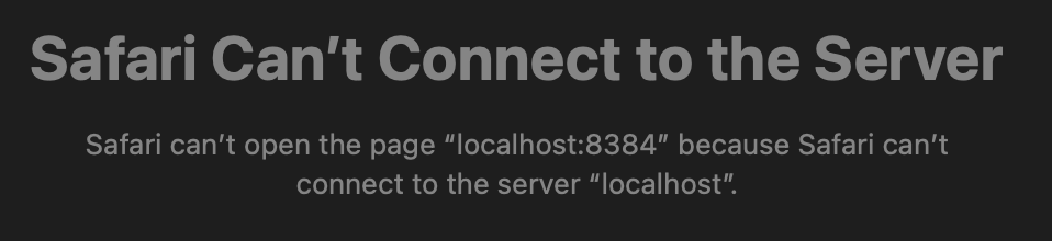

On the MacBook Pro I am unable to see the SyncThing browser interface as it claims that that it cannot find the server, so I cannot do much trouble shooting there…

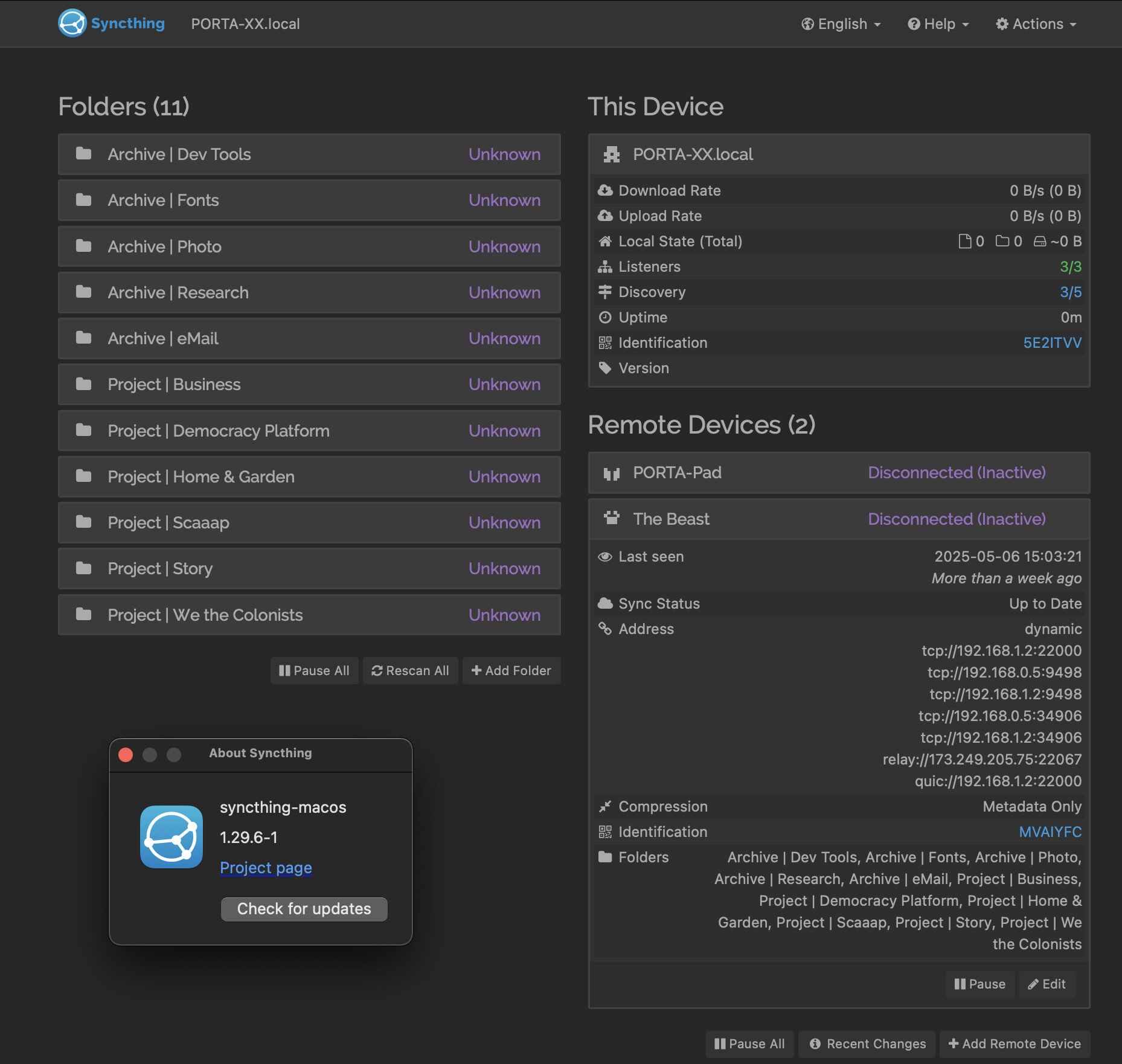

The first screenshot is the MacBook Pro (Porta-XX) showing the browser interface and the floating About window indicating the current version of Syncthing installed.

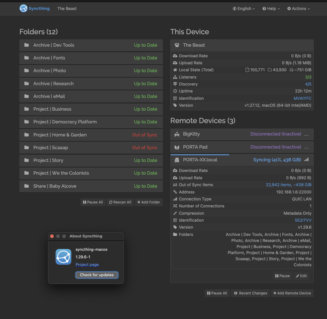

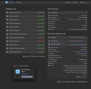

The second screenshot shows the browser interface for the Mac Pro (The Beast) plus its floating About window indicating its version of Syncthing.
A few things jump out at me: there is no version number in the MacBook Pro interface and in the Mac Pro interface it disagrees with what the About window shows.
Both machines are at the latest version of Syncthing, I was incorrect earlier as I got my information from the interface.

It looks a lot like PORTA-XX has lost connection with all other Devices in your Syncthing cluster. Is PORTA-XX on 192.168.1.6 with The Beast on 192.168.1.2? Can they ping one-another?
Please post the output of lsof -i -n -P | grep syncthing on both systems – this will show what ports Syncthing has open, and may lead to a better understanding of why these systems are not communicating.
