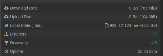

I think this status panel is showing me that I have 124 watches. Nowhere near 8192…

… and I see that this is not just a system that syncthing uses! That explains it.
