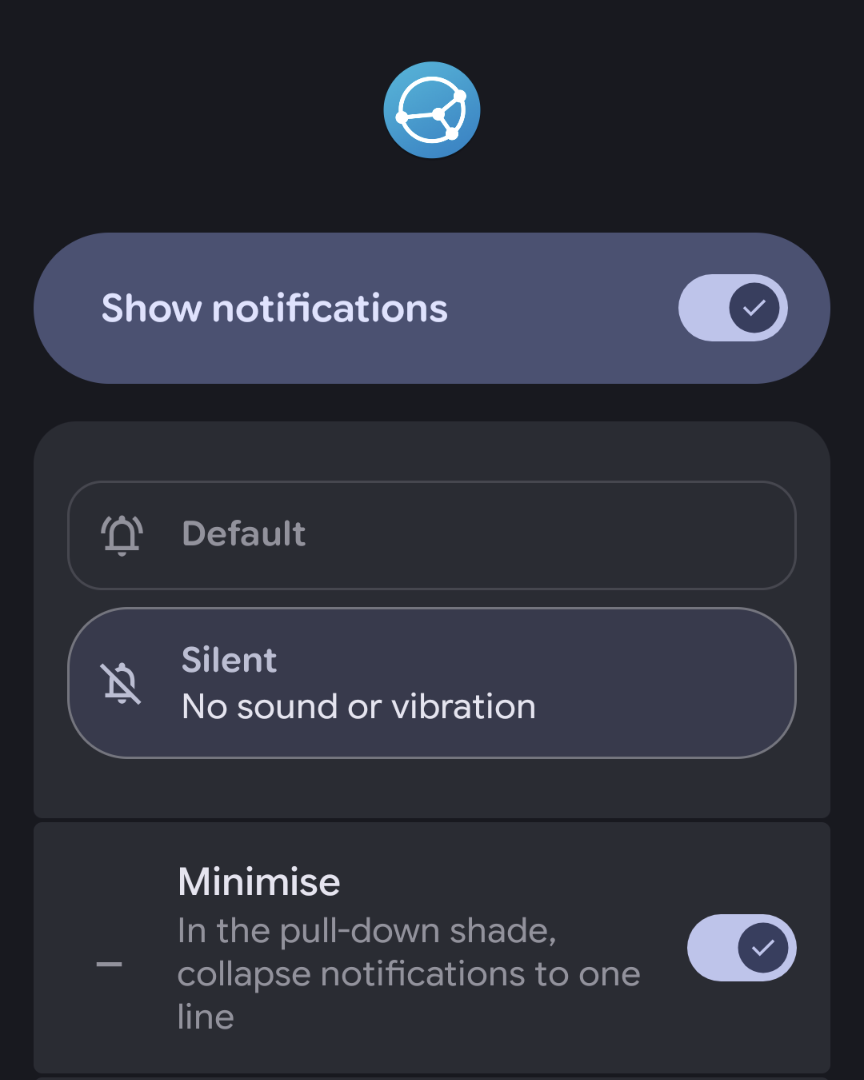

I don’t use the Android app anymore so I can’t say a certain if this will work for you but here is what my research has found.
Hi Wank,
Thanks for the input but that doesn’t work as there are no categories. Like i had said the original app didn’t need the notification visible and I never had issues with the app not running.
