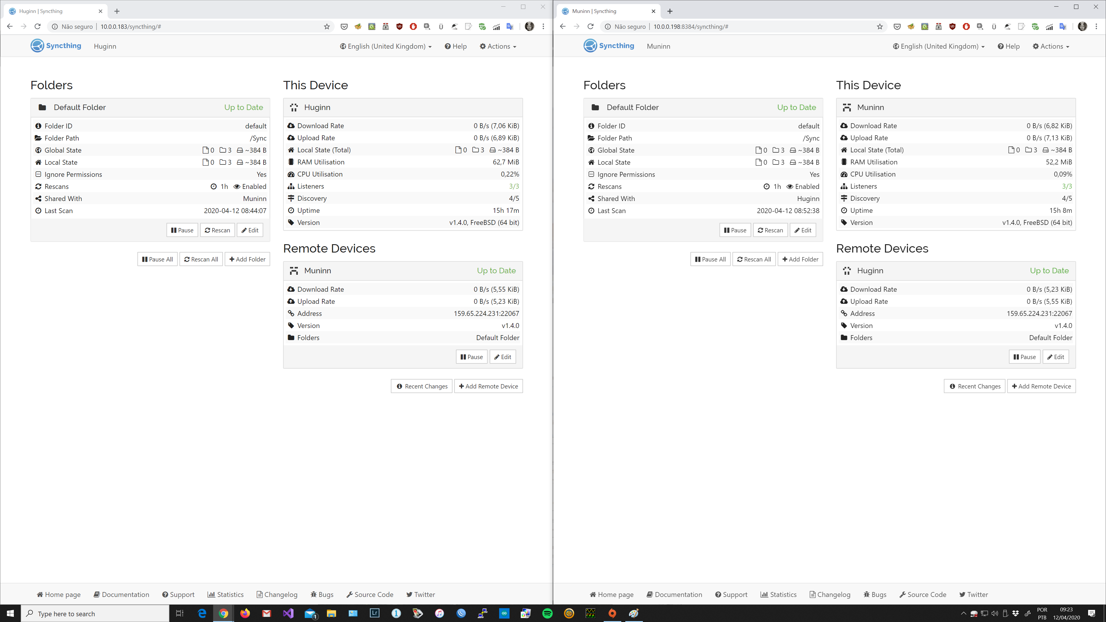

Now on to the problem. Both servers indicate they’re up-to-date. Allright, they should be.
But then I create a txt file in each server, each with one name, and they don’t replicate to the other server.
I tried to rescan but it doesn’t seem to be working.
Any suggestions?

Yes, yes, and yes, sir!
Syncthing|690x388
The folders are in sync. The folder path for some reason is /Sync not ~/Sync as you might have expected, so perhaps you are creating your text file in the wrong place.
