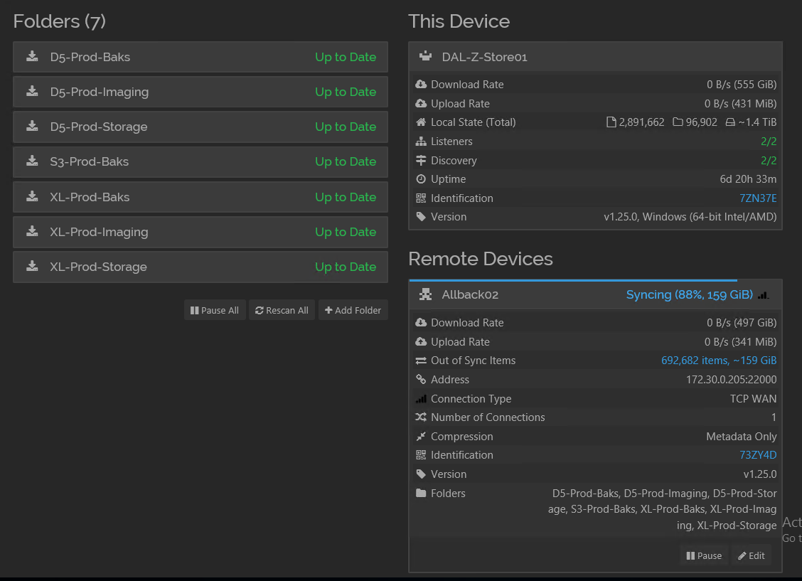

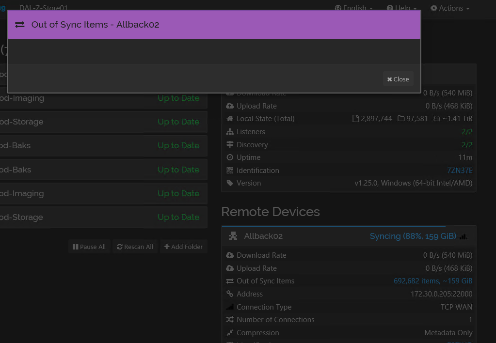

I have a 3 tier setup where I have multiple send only primary servers (we will call them A) syncing to a second receive only server (B). There is a 3rd receive only server (C) that syncs with B. While there are multiple A servers they are each syncing their own folder so a file changed on one A server will never exist on or need to get synced to another A server. All the A servers can communicate with B and B can communicate with C but the C server doesn’t have access to the A servers. Hopefully that all makes sense. My issue is server C shows server B is always out of sync, and when I click to show which files are you of sync the list is empty. The number of files and the size have been constant for several days now.

This picture is from the C server showing the status of the B server

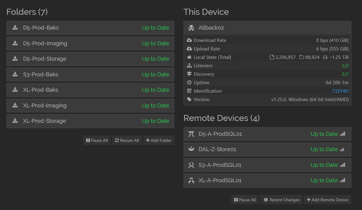

Hopefully these help. This is server B
This is server C

Thanks, the updated screenshots were very helpful.
One thing that stands out is that the difference in the local state file counts for B and C is very close to the number of out-of-sync items: 2,891,662 (C) - 2,206,957 (B) = 684,705
Since the screenshot for C didn’t indicate a warning about local additions, check for permissions issues.
I’ve checked permissions on both ends and the user Syncthing is running as has full control over the folders. Is there a way to see what files it thinks are out of sync? When I click on the Out of sync items on C I get an empty list. Alternatively is there a way to just reset everything? I’d be fine letting it rescan if it got rid of this issue.
If I’m reading the state correctly server C thinks there are ~700K items that need to get sent to server B. That’s why C’s local state has so many more items than B’s local state. Is that the proper reading of the data?
See Syncthing’s documentation about its –reset-deltas option.
Yes.
