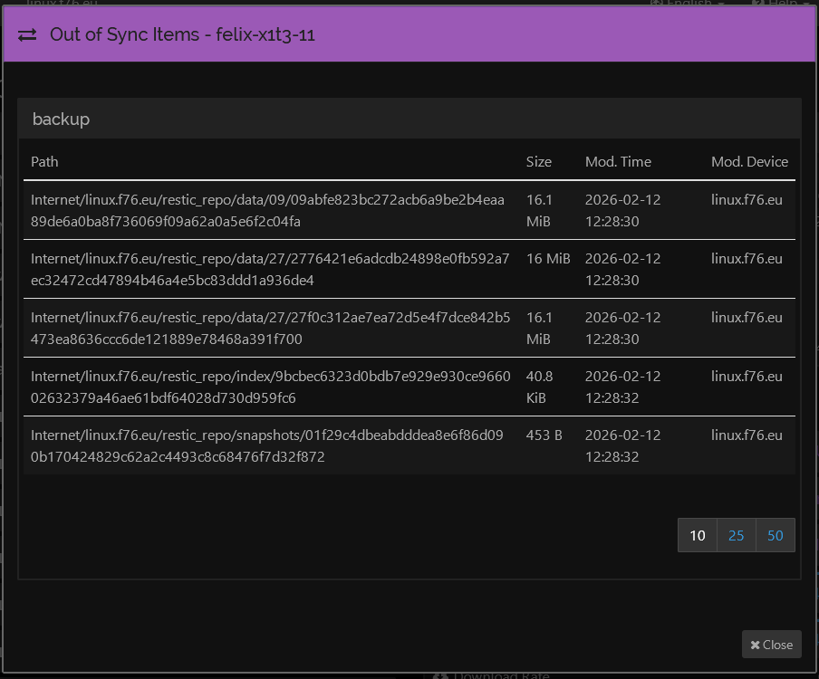

I have a couple of files that are out of sync since weeks. The server, which runs Syncthing v2.0.15, Linux (64-bit Intel/AMD), reports:
Permissions are the same as other files in the same directories:

The peer felix-x1t3-11 runs v2.0.15, Windows (64-bit Intel/AMD). There is no permissions problem either.
There is another peer, for which the server reports the same issue. This peer, however, is configured to ignore the directory containing the files in question. So it wouldn’t receive them either way.
Because two peers are affected, I conclude that the issue lies with the server which provides the files. I wonder if the issue is related to the upgrade to version 2, which I did some weeks ago.
How do I fix that?

Thank you for your suggestions! In the screenshot in my original post, you can see that the following file is listed as out of sync on the sender side:
09abfe823bc272acb6a9be2b4eaa89de6a0ba8f736069f09a62a0a5e6f2c04fa
The Mod. Device is linux.f76.eu, which is the sender, running v2.0.15, Linux (64-bit Intel/AMD). The file is in the file system of the sender, but it doesn’t make its way to the receiver. I double checked that using find.

All five files listed in the screenshot in my original post are missing on the receive side (Windows):
2776421e6adcdb24898e0fb592a7ec32472cd47894b46a4e5bc83ddd1a936de4
27f0c312ae7ea72d5e4f7dce842b5473ea8636ccc6de121889e78468a391f700
9bcbec6323d0bdb7e929e930ce966002632379a46ae61bdf64028d730d959fc6
01f29c4dbeabdddea8e6f86d090b170424829c62a2c4493c8c68476f7d32f872
Other files living next to these are there.
(As mentioned in my original post, there is a second receive side, for which the same sync error is reported. This side, however, is configured to ignore the directory containing the files.)

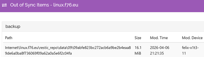

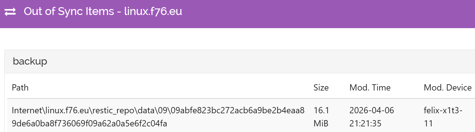

I tried that with one of the files that are reported as out of sync by the sender, linux.f76.eu. Now, interestingly that file shows as out-of-sync by the receiver, felix-x1t3-11, to which I copied it by scp:
Is there any other way to mitigate the issue, or should I simply remove the folder from Syncthing on all three devices and re-add it? (after making sure that they all have identical content)
