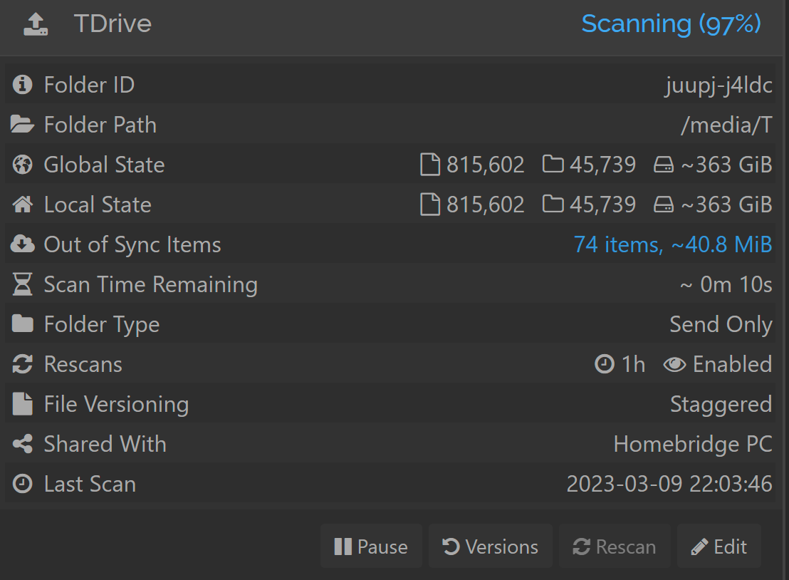

I am attempting to clone 2 entire drives. T Drive is:
Z Drive is the larger of the 2:

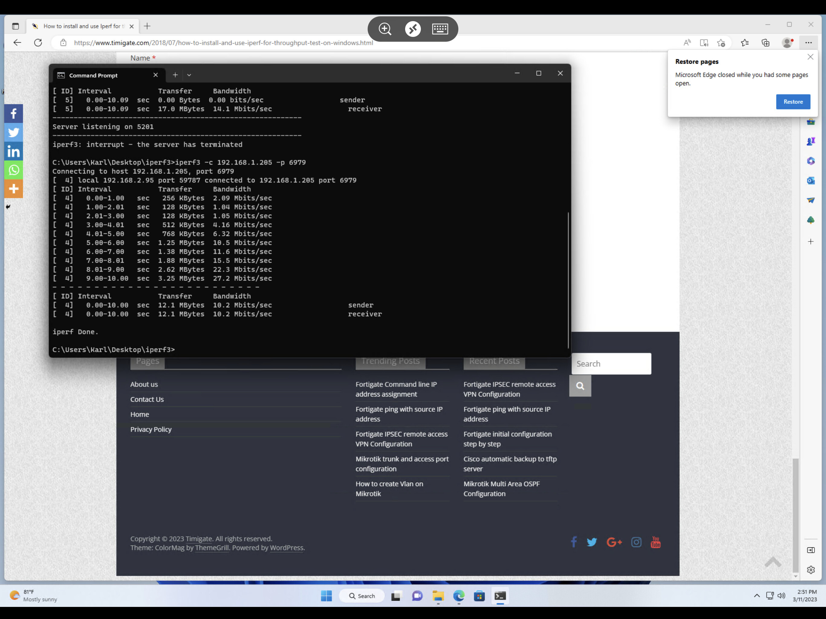

Ok, so I ran iperf3 from both sides and I think the tunnel might be the issue, I’ll fool around with it and try it without the tunnel over the weekend. Also, the NAS has another dual 10G nic card installed (the 4 Ethernet ports aren’t used) that are bonded and connected directly to the 10G switch with DACs. Yes on unraid it is running in a container. I don’t have anything pinned so the container has access to all the resources. Currently sitting at 9% usage. No antivirus software on either machine at the moment other than the stock windows defender BS on the homebridge machine. Office side:
Home side:

Ok, a little more of a wrinkle. I just realized my primary wan connection is down at my office, so I’m running on my backup which only has a 1000/40 speed. I’m sitting at home on my wireless iPad running Iperf and I’m getting the expected speeds over the WireGuard vpn bridge. I’m going to try and install SYNC directly on the NAS to rule out the SMB share slowing it down. Do you think that is a good idea?
Home to Office
Office to Home
You’re welcome. By the way, as a convenience, iperf3 has a -R option for reversing the transfer direction (default is for the client to send/upload to the server).
In your screenshots, when the Unraid box is uploading to the HomebridgePC, there were 55 retries, but in the reverse direction there were none. That’s a lot of retries for less than 20MB of data. Try extending the length of the test to see if the errors increase. For example, a 60-second test with status every 5 seconds:
iperf3 -t 60 -i 5 -c 192.168.2.95
Also run a jitter test like this:
iperf3 -t 60 -i 5 -w2M -u -b 900M -c 192.168.2.95
If the jitter is high, lower the bitrate (900M = 900Mbps) to try and find a sweet spot.

Definitely seem to have an issue on the office side with retries. 611 during the 60sec test. Port issue?
Jitter seems to be ok?
