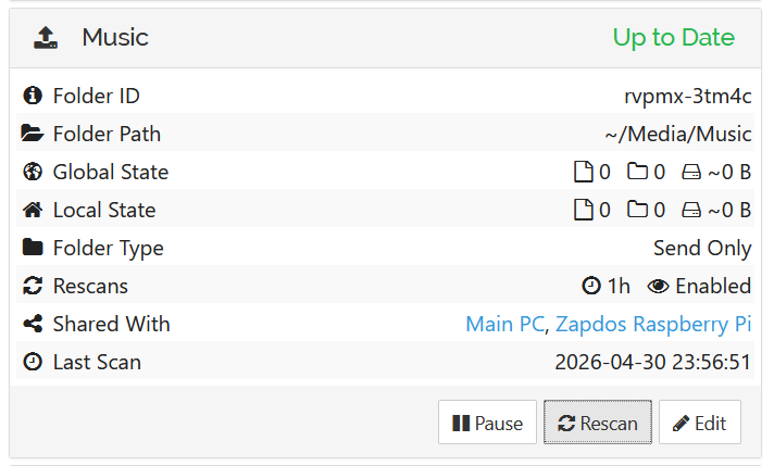

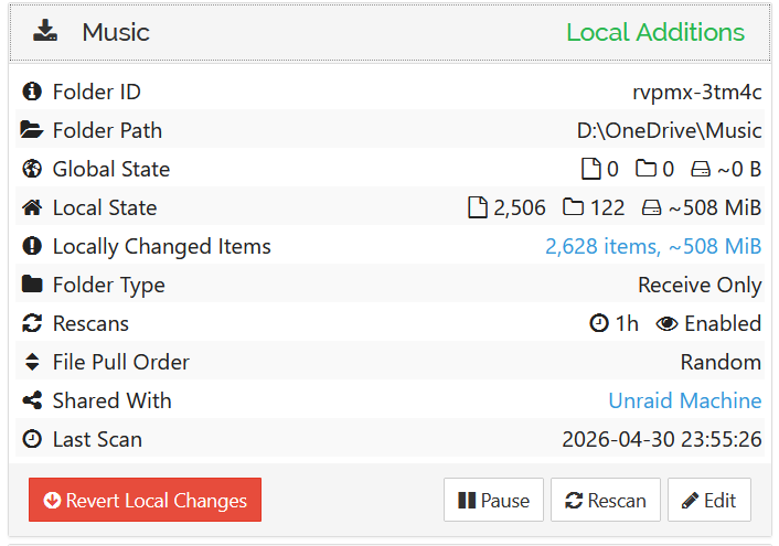

I have one folder where the files just aren’t beeing seen. It’s a send only folder on Unraid. On the windows end, there are some exisiting files in there, but it’s receive only so it should be fine, but it wants to “revert local changes”. What could it be?
Syncthing has found changes on the “Recieve Only side.
“Revert Local Changes” would cause the Receive Only side to be forced into the same state as the Send Only side for the same Folder. Do you want files to be deleted for that purpose?
What is the home path of the user running synchting on your unraid?
I doubt that ~/Media/Music is a folder which unraid exposes and is the one you want to sync.
I don’t. The receive only side is mostly empty, there’s a few files I want to send over, but the bulk is on the send side. I might need to save space on the receive side so I don’t want to send it both ways incase I remove the files (on the receive side) and they get deleted on the send side. If I set to send and receive might one side get wiped out?
On Unraid’s side /media (the root files path for the whole docker) is linked to /mnt/user/ (where all the shares are located) So we are pulling from the Music folder in the media share. I do have other folders synced to the Media share location.
I’m still having this problem @chaos @wweich any ideas? I think i’ve had the docker paths pointing inside of the docker image somehow as the docker image has swelled to over 130GB. Everything looks fine though.
Ok I think I found the solution, I have to map the folders to /media/share_name/subfolder_etc to go where I want to. So /share_name just put it straight in the docker image.
