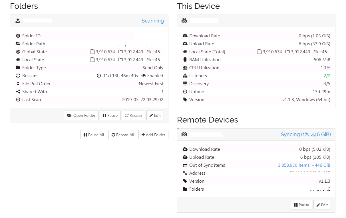

Hello!
I had successfully aprox 4m files in sync, until my syncthing instance was building new index… Now i had problem with errors (file “files\56bcd6df-a950-496c-84a6-55a6ba837d8b\Envelope.xml”): file modified but not rescanned; will try again later) but nothing was changed (only index was rebuild)… After one day errors has stopped, but folders does not seen as in sync…
Now when index is rebuild sycthing has .tmp duplicates and my storage disk is almost full of this duplicates… How can I fix this?
32 I can’t remove/rename/move 4mil of files because is too much of job for file managers memory…

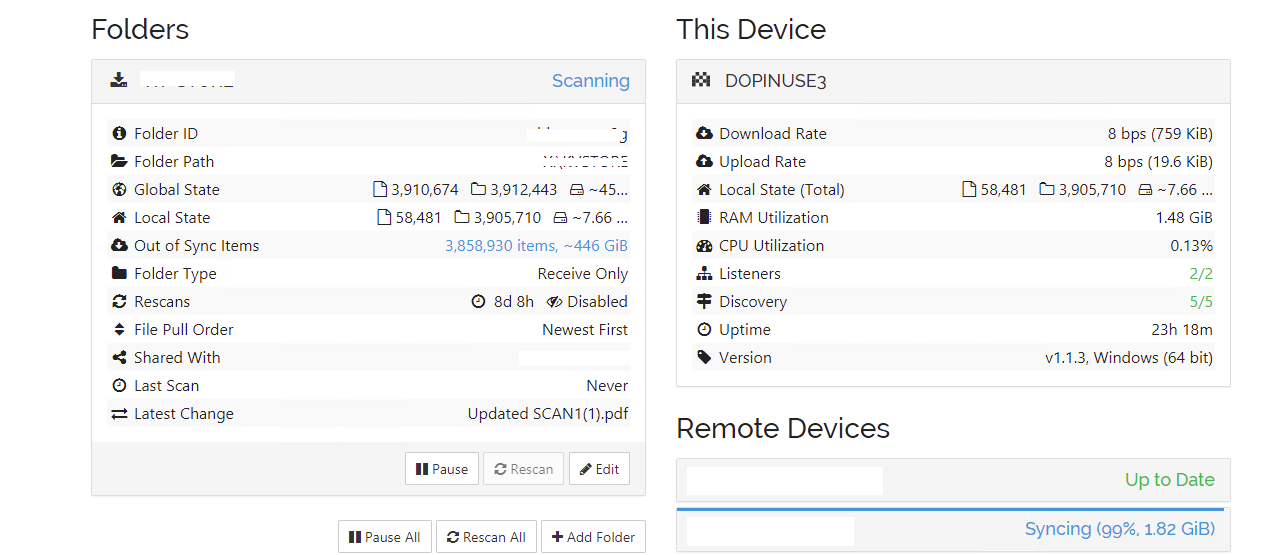

Well both OS are windows and folder paths are in same case. I not sure what caused that error, because nothing was changed on file system and now I deleted index and started the sync again, temp files are being deleted and scanning shows successful progress.
Will report back when scan finishes.
