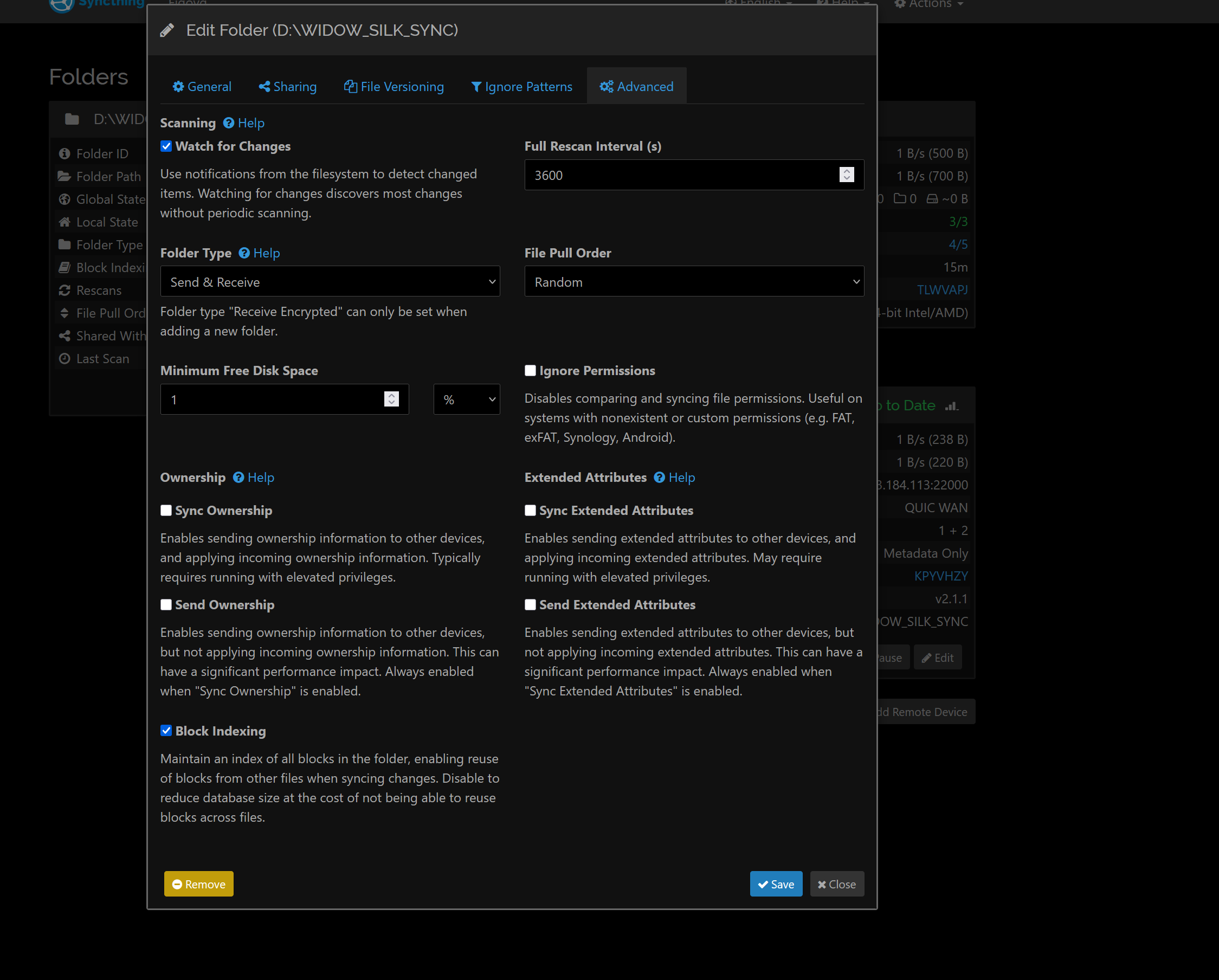

My end is Send and Receive,it is my folder I am trying to share, and does not have a password. We tried both ways actually, I shared a folder and he shared a folder but both ended up with the same result. He says on his end when he was sharing he did not set a password. Even showed me a screenshot of his end and it was “Send and Receive”.

It’s definitely not related to disk encryption or different file systems. It’s about the sharing password being set. If you tried both ways, then maybe a password was set somewhere unintentionally. Sometimes a password manager will fill it in eagerly. Remove again on both sides, add it on one side again. Make sure you DO NOT set a password next to the checkbox for sharing with the other device. Then let your friend accept the invitation and make sure they also don’t input a password next to your device name on the Sharing tab.
Yep that was it, my friend had a password set that did not intend to do so and he wasn’t aware.
