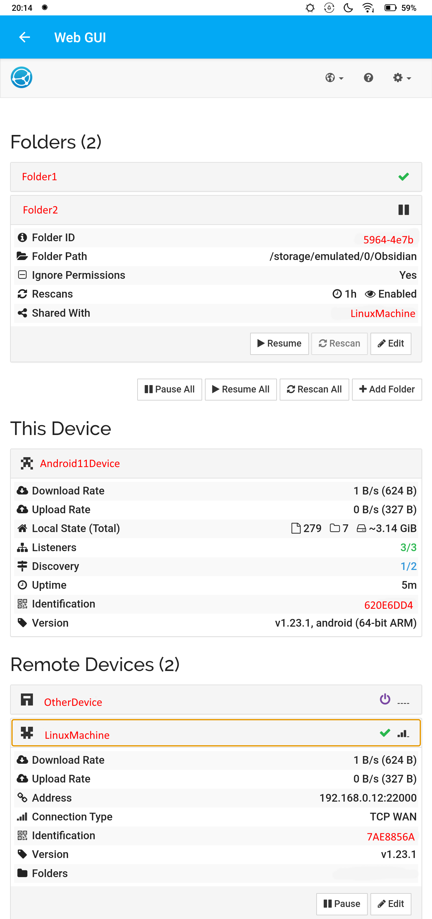

can you add screenshots showing the Web GUI on both devices (with any possible error messages visible)?
Sure, see below. There are no errors displayed other than those in the logs. I had anonymised the logs so I had to anonymise the screenshots of the WebUI too, but all names and IDs should match:
Linux Machine
Android 11 Device
