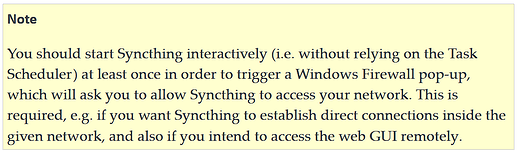

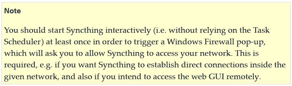

My guess at this point would be that maybe Syncthing was being blocked by the Windows Firewall (see the note at the bottom of https://docs.syncthing.net/users/autostart#run-at-user-log-on-or-at-system-startup-using-task-scheduler).
