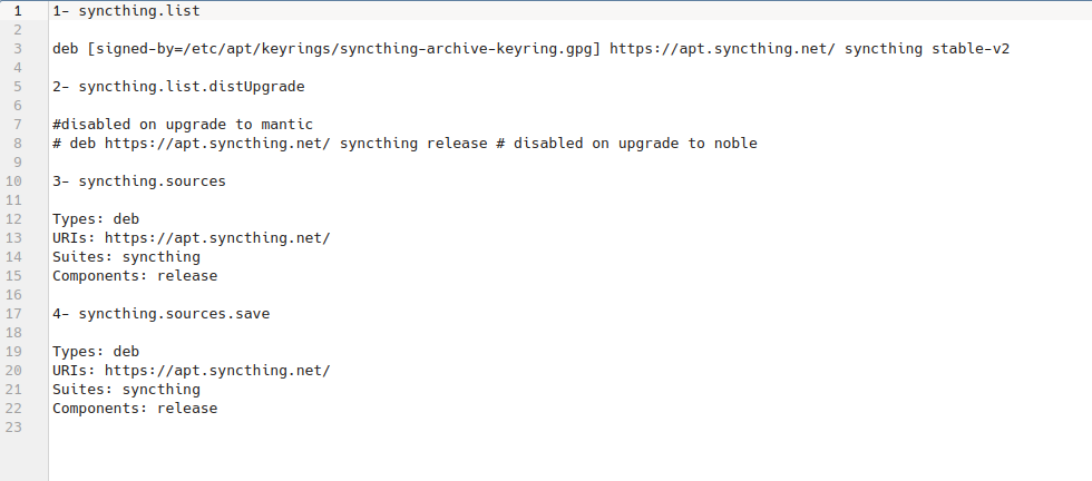

I have found 4 files containing the URL:
1- syncthing.list
2- syncthing.list.distUpgrade
3- syncthing.sources
4- syncthing.sources.save
I have attache the screen shot as this text box trow an error on submission (too many URL)
Grateful for any help from anyone. The problem is not a pleasant experience, but also a good opportunity for learning.
H.
I’d delete everything except for syncthing.sources.
I’d delete all four of them and simply follow the instructions at https://apt.syncthing.net again. That will be the right way.
Make sure you choose the stable-v2 variant if you want the modern version.
