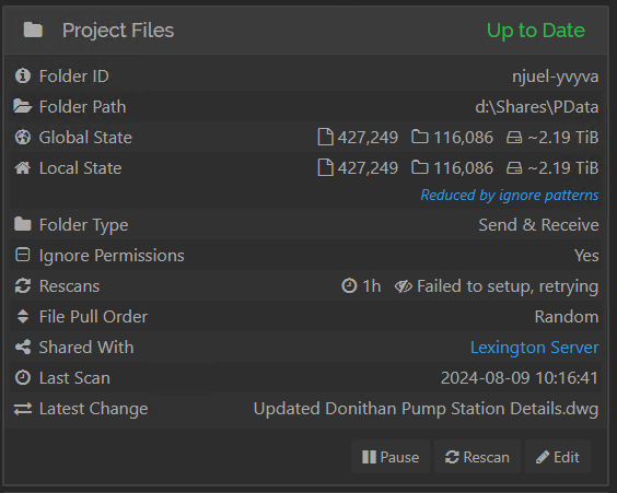

Started a new sync task this morning and as it got started, I saw this:
Even though it says it couldn’t create the folder (which was already in place), it is copying files and appears to be working. However the error message is still in place.
Any thoughts?
Can you post a screenshot of the Web GUI with the folder in question unfolded? What is the actual path on the disk?
There you go (the server with the error message): image
This is the other server: image
The error message is about file watching not working (which is visible in the screenshot, i.e. “Failed to setup, retrying”). The folder path itself looks fine, so it’s difficult to say what the culprit may be :confused:.

2024-08-09 13:11:24 Error while trying to start filesystem watcher for folder "Project Files" (njuel-yvyva), trying again in 1h4m0s: CreateFile /D:\Shares\PData\: The filename, directory name, or volume label syntax is incorrect.
That’s basically the error displayed. That path with the slash in front of it makes no sense. Am I looking at restarting/rebuilding this sync folder job?
Generally speaking, don’t run Syncthing against a network mount, run it on the device where the disks are. Unless it’s Synology I guess, because then it’s going to suck either way :person_shrugging:
NAS… if only we’d started with that bit of crucial info. :wink:
File watching relies on a feature in Windows, macOS, Linux and other supported OSes. With limited exceptions, a client OS doesn’t have direct visibility into remote filesystems – i.e. the server OS hosting the physical storge volume doesn’t send change notifications across the wire to the client OS.
So network file share mounts generally must rely on regular scans to detected changes. The error above will persist until “Watch for Changes” feature is disabled for that Syncthing folder.
