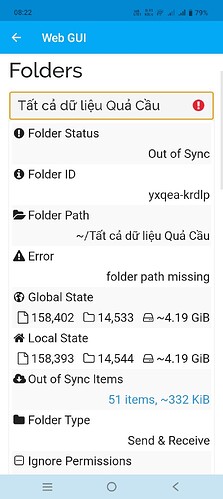

I have a Windows computer using v2.0.3 and an Android phone using v1.30.0. It was working fine, but suddenly since yesterday the sync stopped working. On the phone the error says “folder path missing” or “out of sync”. On the computer it says nothing. Here is the recent log in the computer:

Troubleshoot where the folder went, on the “folder path missing” side.
I get the idea, but I don’t know which specific folder is
On Android, please check the Web GUI. You can access it from the left slide-out menu.
The path is
~/Tất cả dữ liệu Quả Cầu
While the correct path is:
storage/emulated/0/Tất cả dữ liệu Quả Cầu
Do you know why the change happened? I suppose any update shouldn’t change paths?
There was a change in the Android app to what ~ means a while back. You probably need to correct the folder path manually.
Shouldn’t there be a notice for users? Also, why did the change should happen?
In the Web GUI, if you go to Actions → Settings, and then to Edit Folder Defaults, you can check the actual path that is meant by ~.
On the other hand, if you need to change your existing folder paths without removing and re-adding them from scratch, you can go to Actions → Advanced, and then under each specific folder change its path to a correct one.
If the folder is located on the internal storage, you can begin the path with /storage/emulated/0/ or /sdcard/ and then add the rest of the path. If it is on an SD card, then you will need to figure out the mount point of the card first. You may need an external file manager (e.g. Material Files from F-Droid) to do it.
