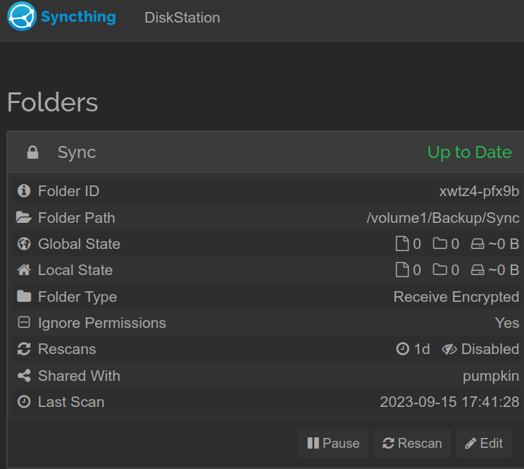

Ok, I rebooted the NAS and this time it added the folder but now it says “Unexpected items” and offers to revert changes. See screenshot:
Difficult to say what is going on exactly. Can you post screenshots of the whole Web GUI from all devices? Also, the global state being zero doesn’t look right.

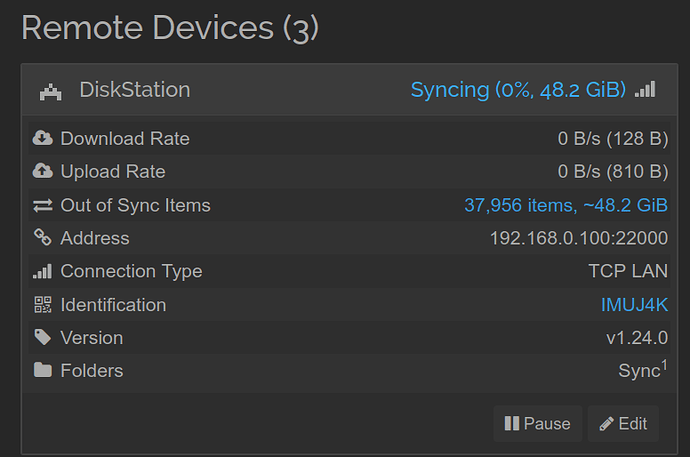

It all appears to be configured properly but it’s stuck on syncing 0% so nothing is syncing between the two devices.
Device “pumpkin” is the desktop computer. I’m not getting any errors, just no syncing.
I think I see the issue in this screenshot. It says the remoted device hasn’t accepted sharing the folder. The NAS is the remote device.
I did click on accept to share this folder though when it asked me to so not sure what’s going on.
Ok, I unshared the folder and then shared again and that error is now gone but now it’s stuck on “Preparing to Sync.” This is getting crazy.
Ok, it’s finally syncing now! Not sure what was going on in the background. Perhaps the encryption takes a lot longer to get going.

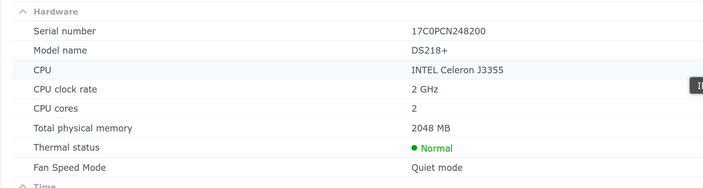

What is the hardware on the NAS? Syncthing itself is quite heavy on resources, however I don’t think encryption should affect it negatively in this case, as a Receive Encrypted folder doesn’t really decrypt anything. It just stores and shares files in their encrypted state.
See hardware screenshot. It’ only using 8% cpu and 25% RAM right now.
