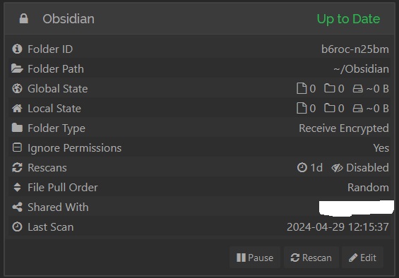

I have an existing share between multiple devices which works fine. I have introduced a new device, which so far I have only added to one of my existing devices and set it to untrusted. I have shared an existing share with this device and given it a password. The untrusted device popped the usual dialogue box and I accepted the share. I can see it shows as “Receive Encrypted”. Straight away, the share went into an “Up to Date” state with 0 directories and files. Sure enough, checking the directory show it is empty and not filled with encrypted files. From the sending device, I note it has a 1 next to the name of the remote device and says “The remote device has not accepted sharing this folder”.
Any ideas what I am doing wrong?
All devices use v1.27.6. This particular remote device is a Pi Zero (armhf). I previously synced unencrypted data to this device with no issues but wanted to encrypt this data. I removed all existing shares, then devices so by the end, it was looking like it was at its deafult config. To ensure this, I stopped the syncthing service, moved my existing config from ~/.local/state to another directory and restarted the service to start a fresh.
Screenshot 2024-04-29 123332
