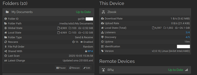

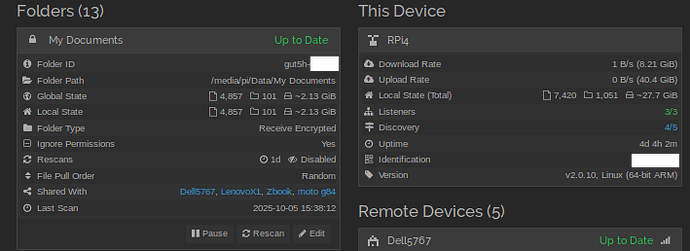

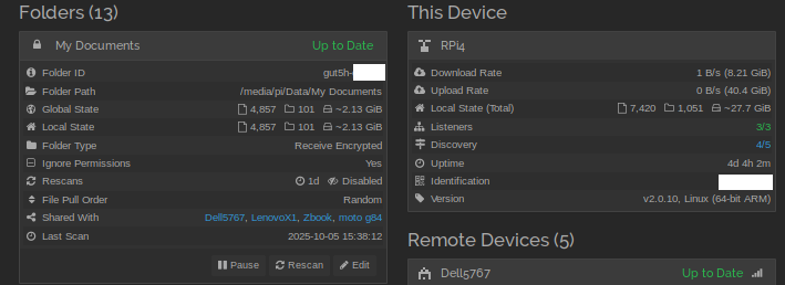

RPi4 (hub) with several encrypted folders shared with three non-encrypted laptops (spokes) running Ubuntu 25.04. All devices are updated regularly and all have ST 2.0.10.
Changing file on laptop A results in similar local/global state for that folder on the RPI4.
Connecting laptop B to the hub updates those changes but leaves earlier version unchanged or undeleted, even though both RPi4 and laptop B show the folder up-to-date, global and local states are mismatched.
The correct file/folder count is that for the device RPi4
Pause/unpause and rescan have no effect.
Unencrypted folders with several hundred files maintain the correct global and local states across all devices.

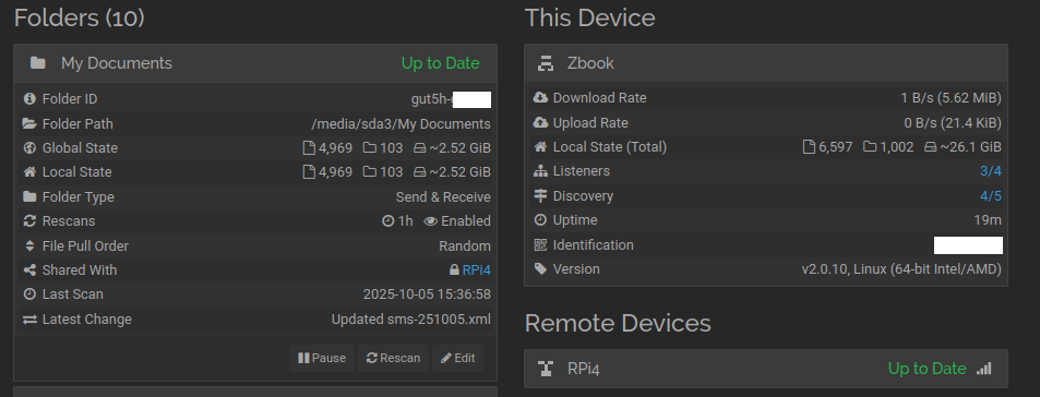

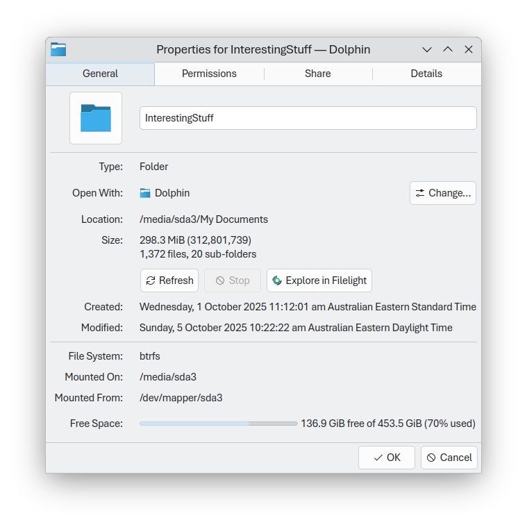

Thanks @tomasz86 Other devices are also showing up-to-date, but are in fact out of sync on disk.
I think the error occurs when the second spoke device comes on line – that’s pretty weird. The folder in the screenshots is encrypted on the hub.
I have recently changed my setup from mesh to hub and spoke, so this issue may have been disguised in that arrangement.

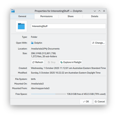

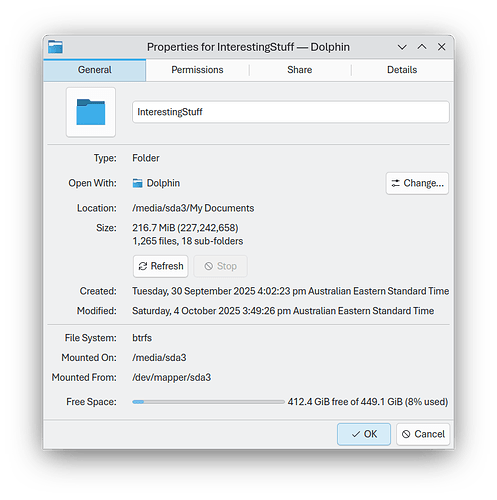

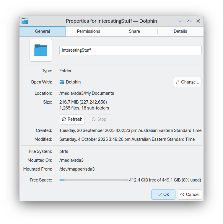

Here are the property screenshots from file manager for the mismatched folders that Syncthing shows as up-to-date.
