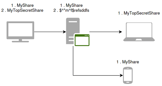

Here is the configuration I would like to achieve:
On my computer, I have two shares :
  1. Basic sharing (word files, movies, …)
  2. Sharing sensitive files
But the problem is that the PC and other devices are not always turned on at the same time. So I use an intermediate server that stores the items I want to share : my sensitive files must only be stored on the laptop.
My unimportant files can therefore be stored without encryption on my server, which is not the case for my sensitive files.
To do this, I tried using the “Untrusted device” option on the connection between my server and each of my devices, but:
  • It amounts to encrypting all my files, even the unimportant ones.
  • the server can only receive data, not send it.
If I choose to share “MyTopSecretShare” with a password but only on my PCs, not on the server, I am unable to send data.
So, as I understand it:
  • the “Untrusted device” option enables encrypted data storage on the destination system (computer > server). The destination can only receive data.
  • encrypted data can only be exchanged between two workstations if they know the password.
My request is therefore as follows:
Between three computers exchanging data only with Syncthing, with one computer acting as an intermediary, is it possible to allow the intermediary to retrieve encrypted data and make it available without being able to read the data?
The request may seem similar to “Untrusted device” but:
  • The “untrusted device” does not need to decrypt the data (it only serves as a relay).
  • The “unreliable device” can still receive non-sensitive data, which can be accessed/used by other means.
Is this a possible request?
Thanks :wink:

I have tried several times, but my computer is always initiating the share (when creating the “send/receive” share, I select the server. On the server, I accept the share) :
  • computer > server, without password: I was able to send files
  • computer (password) > server (encrypted reception): the sender can see the file that has been added and is “waiting” for the remote device to accept the share. On the server (the remote device), I did receive a sharing request from my computer (which I accepted). But I can’t enter a password and it’s set to “encrypted reception.”
  • computer (password) > server (send and receive): I get the error message “Failed to verify encryption consistency (folder.label=test4 folder.id=my_folder_id folder.type=sendreceive device=my_device_id error=“remote expects to exchange plain data, but local data is encrypted (folder-type receive-encrypted)” log.pkg=model)”
