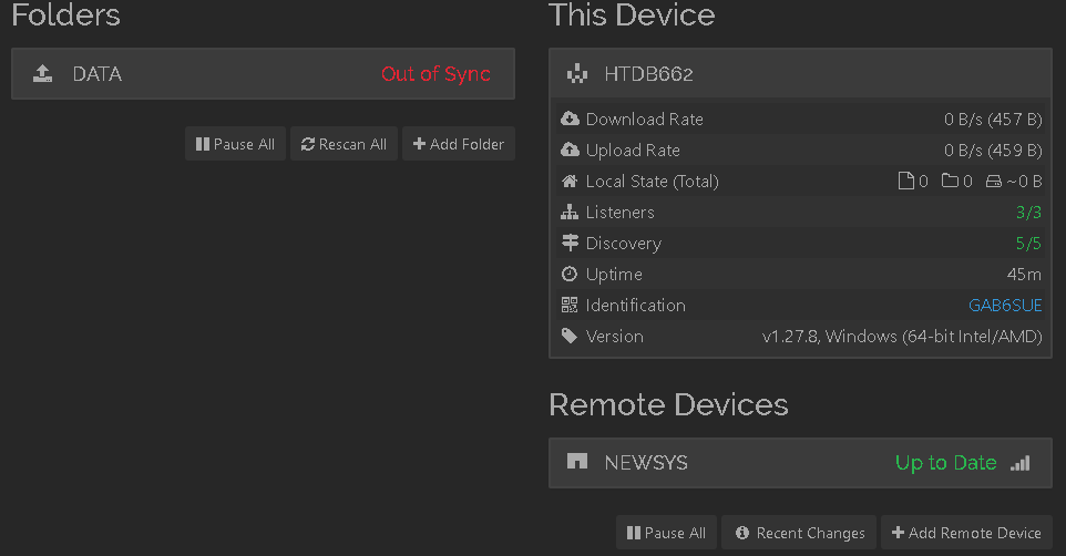

  2. 1st attachment shows the GUI on local, 2nd the GUI on remote. Shouldn’t they both show everything up to date – why does one show out of sync? Can you pls clarify this for me?

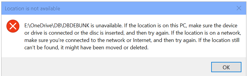

  3. When I try to access the remote folder I get the message it is not available (3rd attachment). Is this normal? Once the syncing was done, shouldn’t the drive be released to access? Is there anything I need to do to keep the folder accessible?
Not only that, but I cannot close the File explorer windows with this message.

Just some old remains or is OneDrive really involved?
I had to clear some directory mess leftover from when I got rid of OneDrive (actually, you cannot rid yourself of it–they bury it so deep into Windows it’s impossible).
