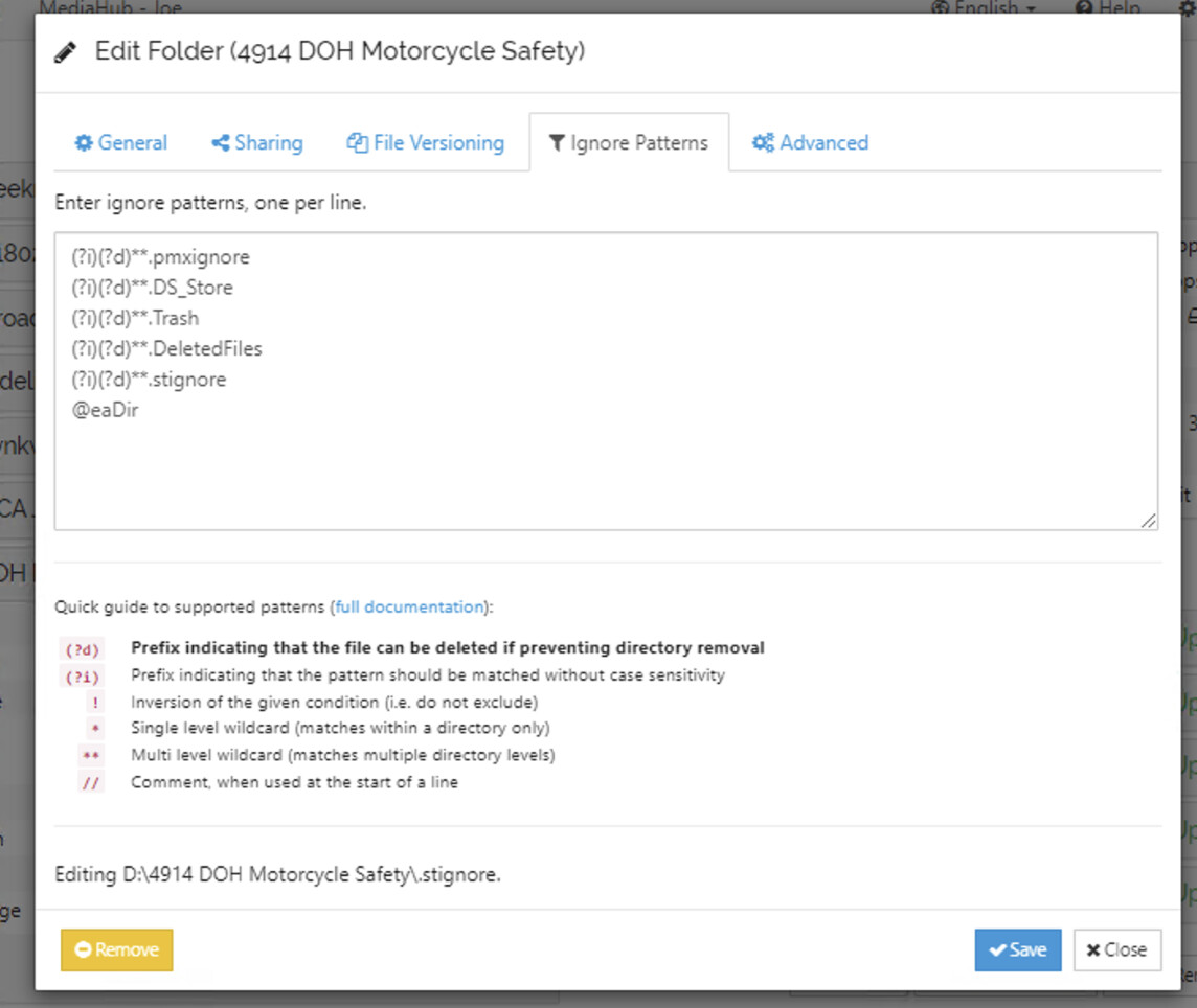

How are you editing the ignore patterns? In the Syncthing Web GUI on Synology? Can you post a screenshot?
I’ve been editing it through the web GUI yes,

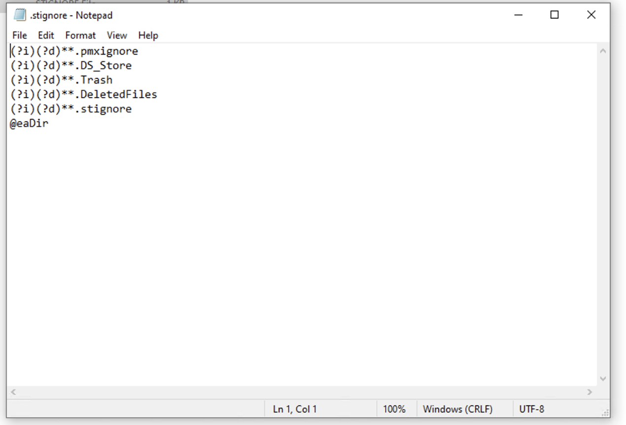

Here it also is just in the .stignore file:
This looks like you’re editing on the Windows side. You need to either add the patterns on all devices or just on Synology. Please keep in mind that this won’t delete the existing files that have already been synced. Those you need to remove manually.
Okay, I have edited the ignore pattern on all devices and manually deleted the @eaDir folders.
