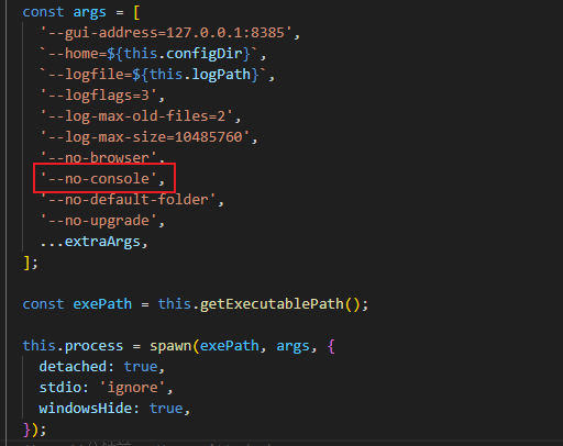

I encountered some problems when starting services using Node.js. Here is my code The startup configuration items are as follows
I am running version 1.3.0 of syncthing on Windows 11, as shown in the picture. I used the ‘- no console’ option, and in the documentation, this startup option was configured to remove the console and also marked ‘Hide the console window.’ (On Windows only). The startup service is normal, and syncthing service was started normally on my PC, but the console was not removed as expected, why? Has anyone else encountered this problem? Can you give me some advice
This is a known issue. --no-console only works if you set the old Command Prompt as the default shell (instead of Windows Terminal).

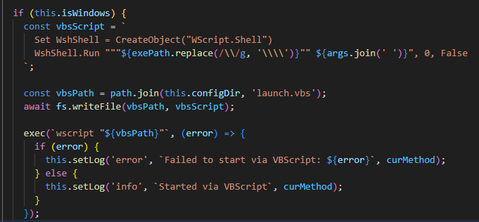

In fact, to solve this problem, I wrote a VBScript calling script and called it through Node.js’ exec. I don’t think this is a good solution. Is there no better solution? My code is shown in the following figure
I’d say VBScript isn’t a great solution, simply because it’s on its way out, so it will likely not be included in Windows at some point (or at least not out of the box).

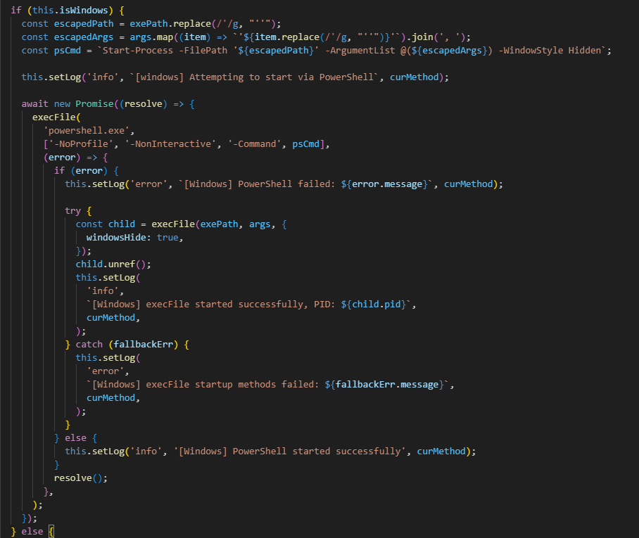

Hmm… My current approach uses the execFile module in Node.js, with PowerShell specified as the launcher to execute the command for starting the Syncthing service. This ensures that my project’s process is completely detached from Syncthing’s process while also preventing the Syncthing console from appearing. If even PowerShell fails, there is a fallback mechanism using execFile to directly launch Syncthing. Although this would link the processes, it ultimately meets the requirement of enabling Syncthing via Node.js without displaying a console window.Here is the code:
