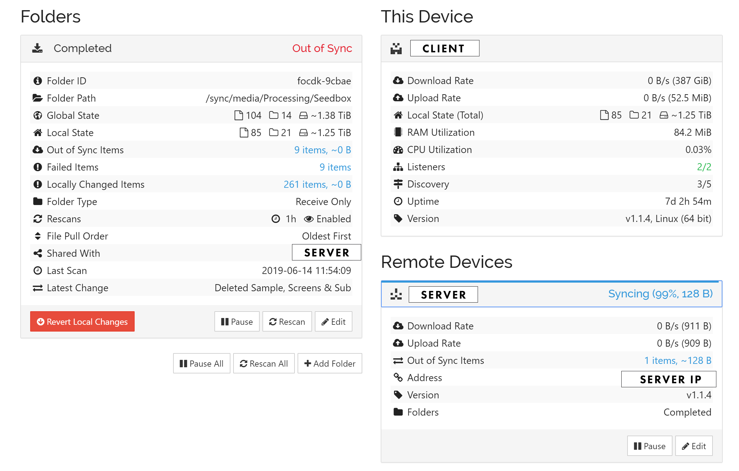

Here are screenshots of each side:
I just noticed that the contents of the deleted directories are in the “Locally Changed Items” list, preventing their deletion.
My goal is a setup where the client is kept in sync with the server, but the server is protected from any changes on the client side. I know I can probably just hit the “Revert Local Changes” button to delete these files, but I would prefer an automated solution.
