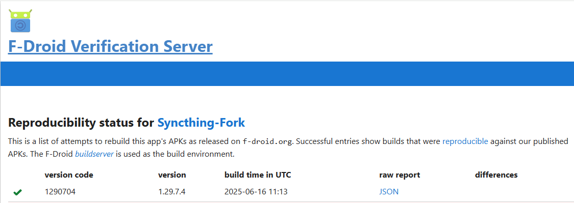

Summary of what we’ve already done:
  • ‘EXTRA_LDFLAGS’: ‘-buildid=’
  • environment “SOURCE_DATE_EPOCH”, getSourceDateEpoch()
  • environment “BUILD_HOST”, “Catfriend1-syncthing-android”
  • environment “BUILD_USER”, “reproducible-build”
Those together already produce a reproducible build within the F-Droid infrastructure (Syncthing-Fork Reproducibility Status).
