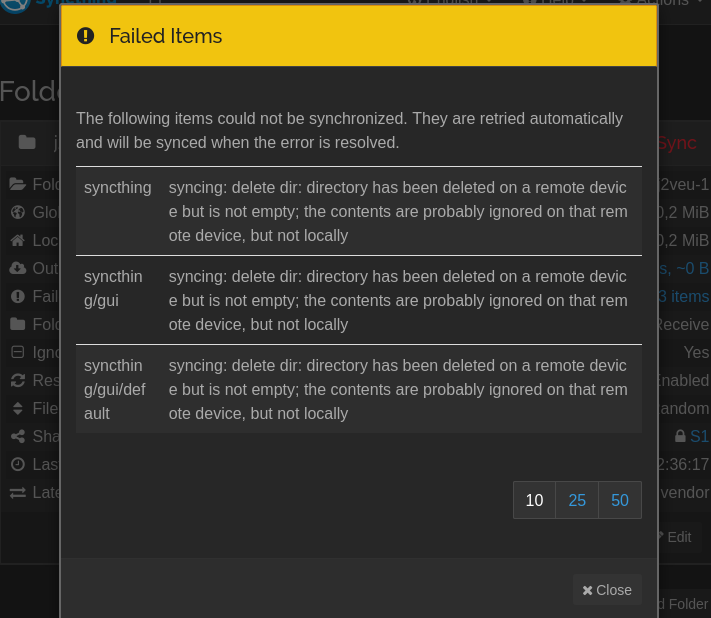

I have a setup with two devices - one Send Only, one Receive Only. I recently deleted several hundred directories on the Send Only device, but syncthing refuses to delete them on the Receive Only device - the error is “syncing: delete dir: directory has been deleted on a remote device but is not empty; the contents are probably ignored on that remote device, but not locally.” (This is incorrect; I have no ignore patterns.)
Is there anything I can do to avoid needing to manually go through and delete the exact same folders on my Receive Only device? Is there anything I can do differently in the future to avoid having to manually delete folders on all devices?

I’m trying to reproduce a deletion bug which seems to be related to encrypted folders. When renaming folders on one side failed items occur almost every time on the other side but are automatically resolved within a minute (or pause/resume):
Always nested folders (3-5 levels deep), maybe processed in wrong order.
Encrypted how? Nothing was mentioned about that in the earlier posts, I suspect you’re dealing with something entirely different
It is quite different but has similar symptoms. Not sure if this is even an issue since it is resolved after a short time, still wanted to share in case it is related somehow. The receive encrypted folder on a central hub is shared with all other devices which only connect to it.
Tested also with regular folders and it is the same, so not related to encryption in this case. The failing items (empty folders) are removed after about 60 seconds.
