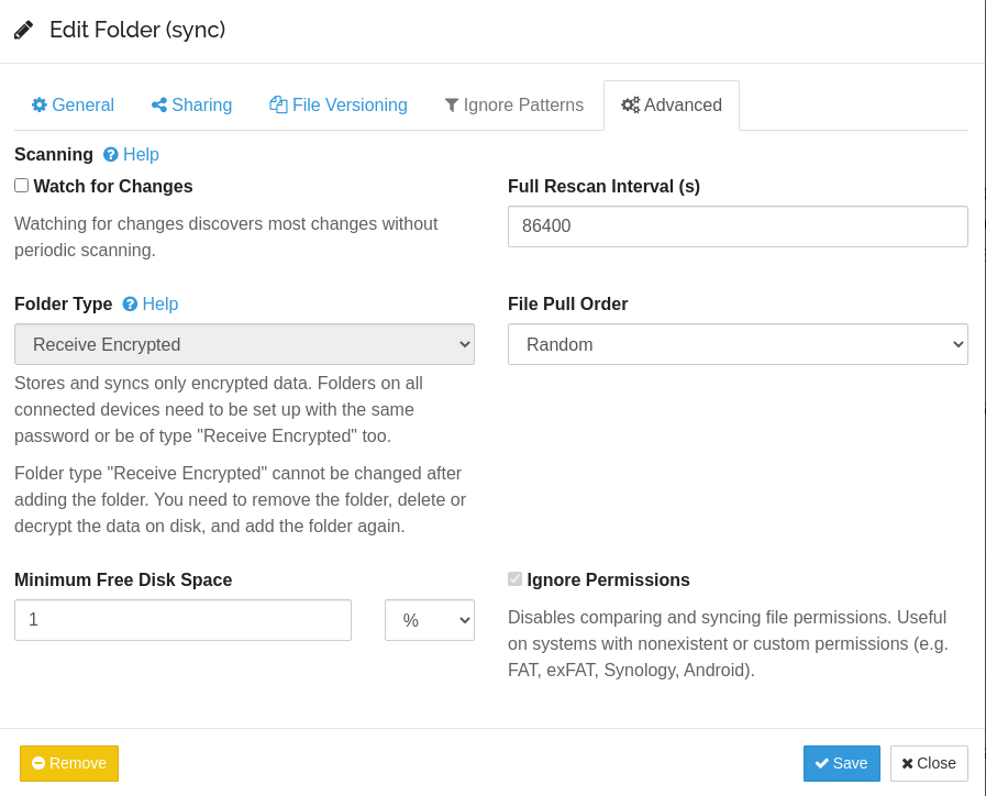

Syncthing won’t let me add a share without password if both devices is untrusted:
Even if I make NUC trusted for pi and synology, I’ll get the decrypting error.

Pi configs:
Synology configs:
The problem is that Pi and synology are configured as folder-type send-receive, while they should be receive-encrypted.
It worked, thank you. That was easier than I expected :roll_eyes:
