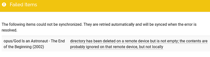

?d: "directory has been deleted on a remote device but is not empty; the contents are probably ignored on that remote device, but not locally"
On Android, I delete folder/+, but this deletion is not propagated to my computer. I ignore + on Android. I get this error in the failed items on the computer:
“directory has been deleted on a remote device but is not empty; the contents are probably ignored on that remote device, but not locally”

Is the file that you want to ignore actually called +? Could you post some screenshots of the GUI showing the aforementioned errors?
It’s a folder, and yes it’s called +.
The error does not look like its talking about +.
+ is a subfolder of the folder mentioned in the screenshot.
To clarify, I’m actually deleting folder (and thus folder/+ as well) on Android. On my computer, everything but folder/+ (and the files it contains) is deleted. I’d like to ensure that folder/+ is deleted as well on the computer.

From device B, delete folder1 (which never had folder1/+ to begin with, but did have folder1).
This results in a failed item folder1 on device A.
What is the content (in the filesystem) of folder1 on A?
Yeah, so I have just tested this myself. I don’t think that this is how (?d) is supposed to work. Basically, you need to have (?d)+ ignored on device A (not B), and then if you delete folder1 on device B, device A will also delete it (together with its + subfolder).
Can contain anything else, but it contains +.
And after deletion on B, it still contains the files it contained before, because of the failure I guess.
Ok thanks for the clarification, I misunderstood then, I’ll try this out!
Ah I missed that bit: Indeed if device B deletes folder1 while having ignored some children, and A has not ignored those children, you will get that error. That’s working as intended, as A is told to delete folder1 but is not told anything about deleting the child, so it doesn’t delete the child. You need to ignore it with (?d) everywhere.
