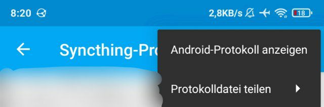

The Syncthing(Native) log is still there. The recent release can switch to show either Android logcat or syncthing.log (see the upper right corner menu). Then hit “share” and “Save to Syncthing”, “Save to Material files” or share the log with your note taking app, for example.
The native output only helps me develop the wrapper when output in real time to logcat. The logcat buffers are “small” so we had users come around over years handing in incomplete syncthing logs when requested because they were truncated. That’s why we now get the “huge” logfile and only output the native’s log lines to the logcat in the debug build. (Release builds don’t do this) That way, reducing logcat spam, I could also remove the “Log to file” option, as you might expect, when needed users hadn’t turned this on before a problem came up.
