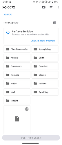

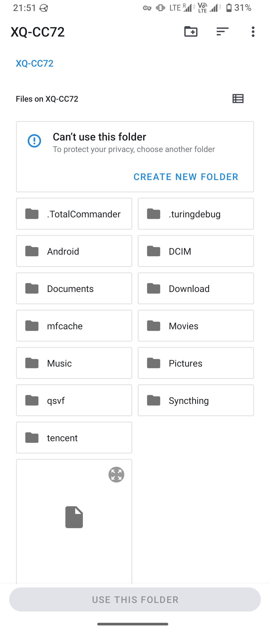

Indeed, my first attempt was to select the Syncthing-Fork’s directory in, I believe, /data/data. But I’m not able to ascend beyond /storage/emulated/0/ in the directory picker. Is there any trick?

The picker won’t work. You need to input the full path manually via the Web GUI. I believe it will begin with something like /data/data/com.github.catfriend1.syncthingandroid/files.
That worked flawlessly. Thank you! It is good to know to always have a backup of my configuration.
