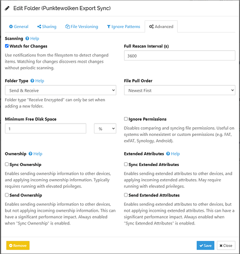

I have this same configuration on all 3 Devices.
C:\Punktewolken Export is the Folder That will Be synced on all Devices.
If WS03 and WS04 creates new Files it should be synced with the host (me WS02)
But… WS02 must be able to delete Files and that schould be synced with the others.
in the other hand WS03 and WS04 bust have the permissions to Create new Filed and sync them with the “Master” WS02 but not Delete Files
That doesn’t sound like synchronization, which is the goal Syncthing was written for. It keeps a certain folder identical between devices, but what you want to do is more or less just a file transfer in one direction.
There are some instruments in Syncthing to achieve “one-way synchronization”, namely receive-only and send-only folders. You might also want to experiment with the ignoreDeletes advanced setting, but it’s use is discouraged because it always results in out-of-sync conditions.
The easiest way would be to sync all three devices with send-receive folder type. You can then manage the files on your “host” WS02, including deleting them, which will propagate to WS03 and WS04. But preventing deletion on WS03 or WS04 to propagate to the others is not something Syncthing can do sensibly. Note that in this setup, WS03 could delete a file from WS04 as well, even if WS02 were configured to ignore the deletion.
