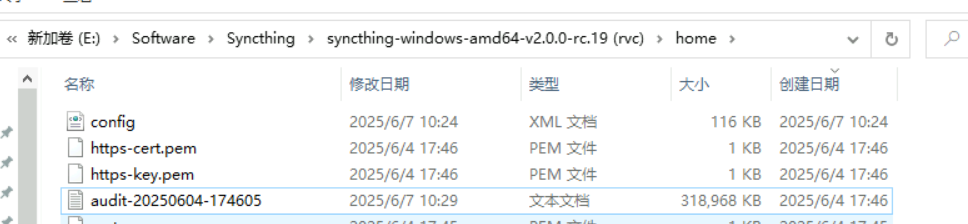

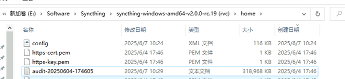

I just enable option [–audit] and running Syncthing 2 days, the audit file’s size is more than 300MB. This is causing many issues as below:

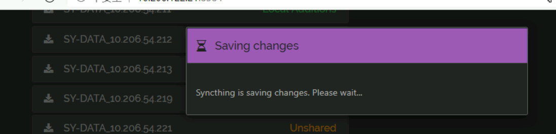

When saving after the operation, it takes more than ten seconds or even longer to wait, I guess that as the audit increases, the time for writing new logs becomes longer.

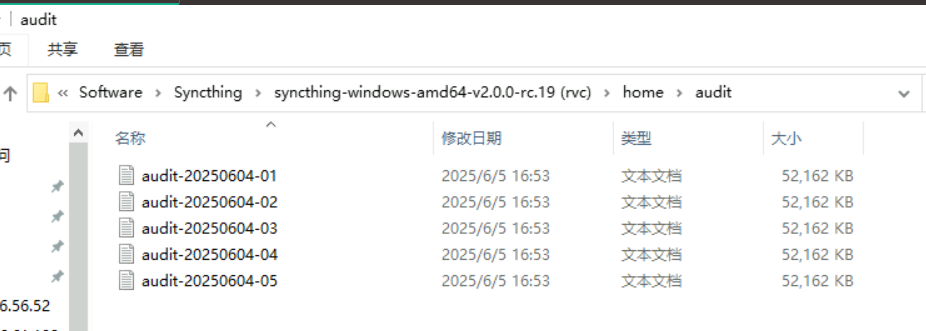

  1. Add a new audit file every hour, as shown in the above figure. In this way, the size of each file is controllable, the write efficiency will be improved, and the memory usage will be reduced.
  2. It supports users to configure the saving duration of audit files, with a default of 6 months. After the expiration, the expired audit files will be automatically cleared.
