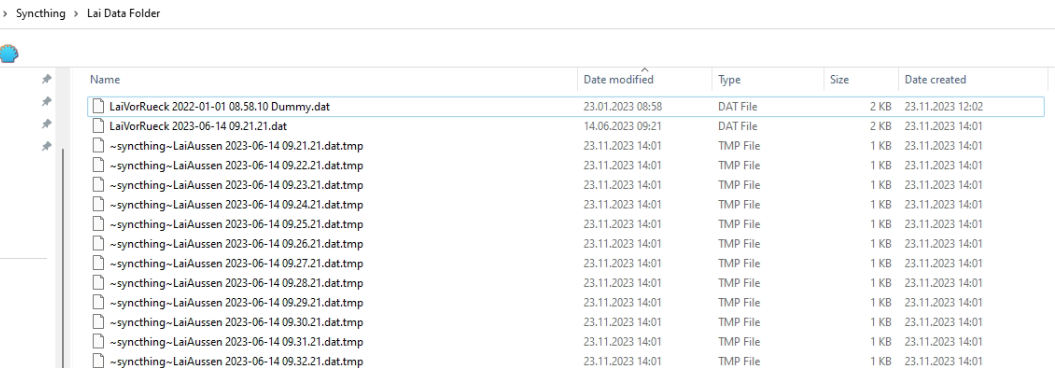

We tried to restart the synchronization anyway. We did set up Syncthing locally and started synchronization. 1 file was downloaded correctly but after that single download it created only files with the following names: ~syncthing~LaiPower 2023-06-14 09.36.20.dat.tmp
We paused the synchronisation after a few minutes, but this did not cure the problem: the files keep this temporary(?) names (actually we have 14.5k temporary files…
I think usually, the files would get renamed after a few seconds.

Restarting sync downloaded one more file and all others are shown as: “~syncthing~LaiPower 2023-06-14 09.36.20.dat.tmp” Even if I Press to interrupt the download…
Is that correct? Seems very strange to me…
It’s correct if you interrupt it. As I said, post logs, & perhaps a screenshot, otherwise it’s impossible to say anything about what’s going on.
