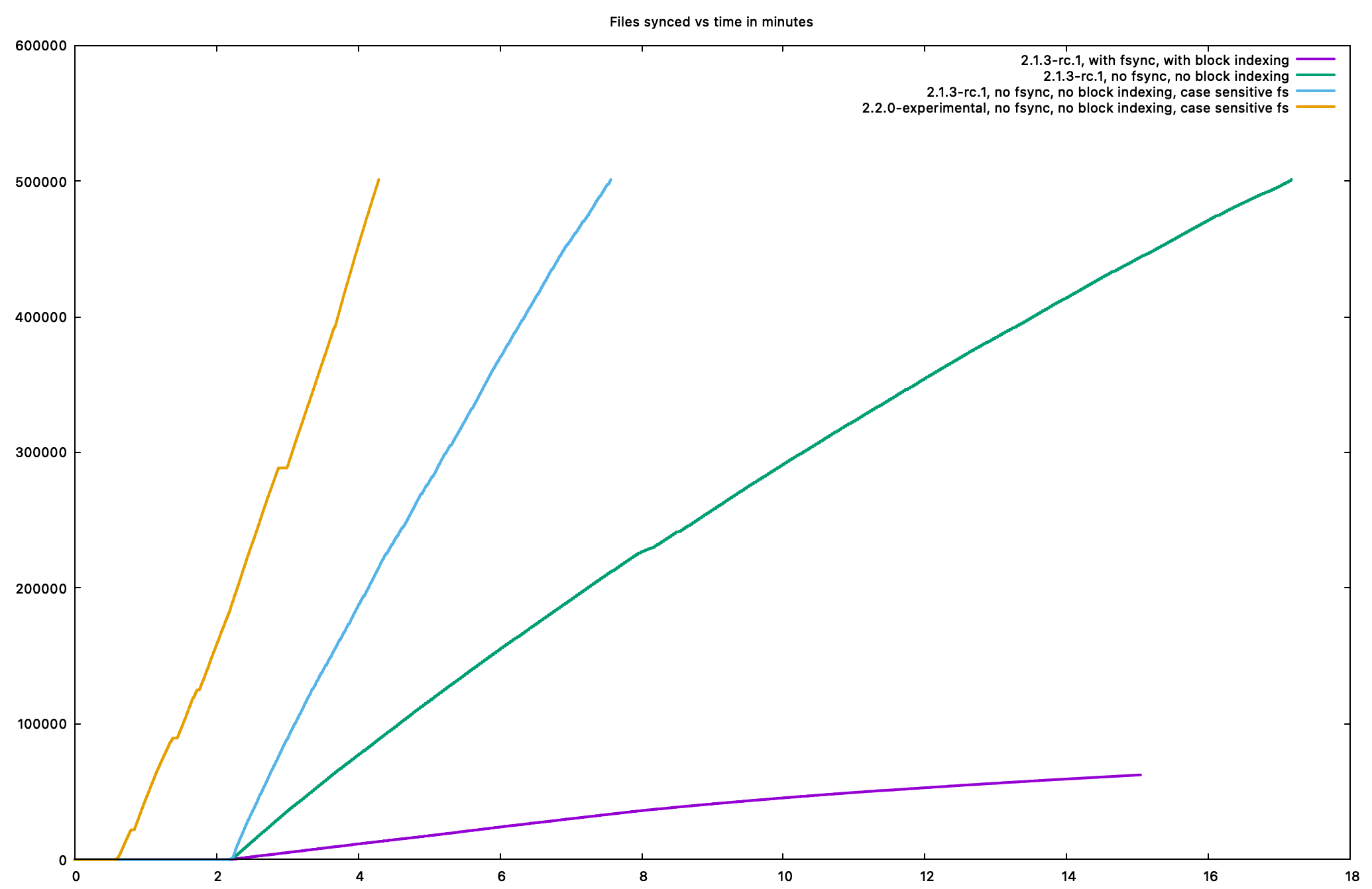

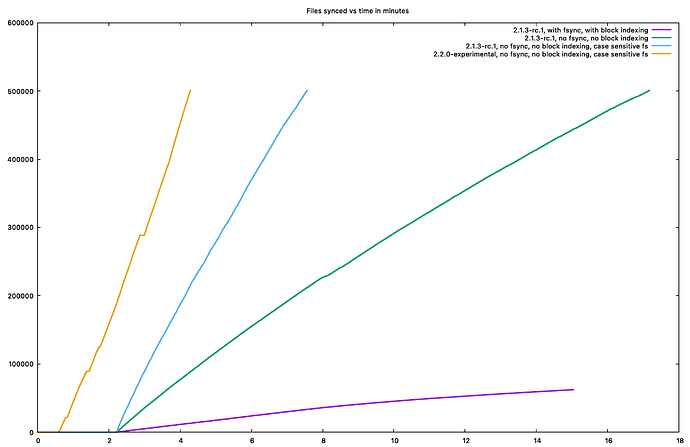

To illustrate, here’s a graph of three runs I did with different settings. It’s minutes runtime on the X axis and number of files synced on Y. With default settings you’re unfortunately on the purple line, which I stopped after 15 minutes an 60k files. Turning off fsync and block indexing puts you on the green line where it finishes after 17 minutes. Also enabling case-sensitive-filesystem gets you to the blue line where it finishes after seven minutes.
It kinda sucks, but these integrity/safety settings come at a high cost.
(The orange line is an experimental branch which happens to cheat by starting earlier, but also keeps a steeper slope so that’s nice.)
