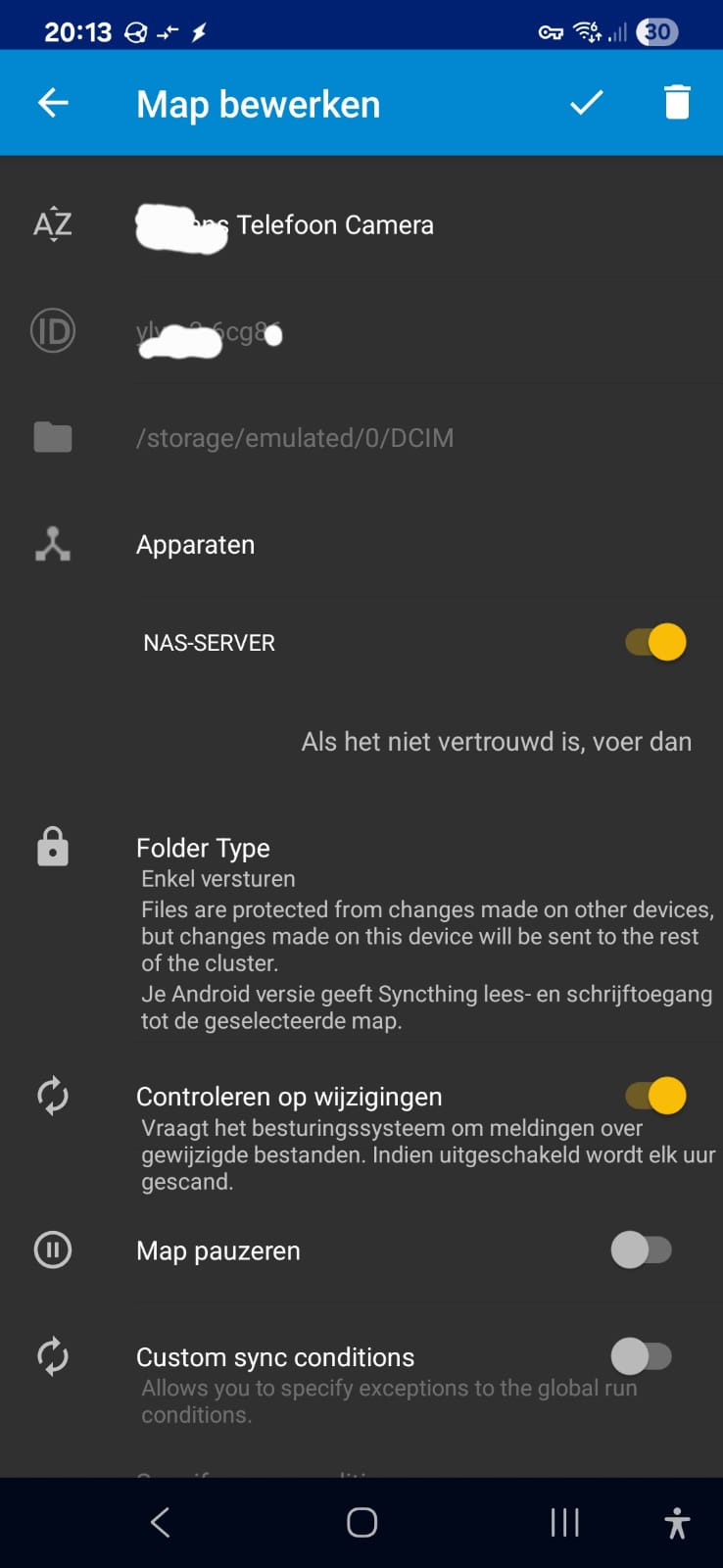

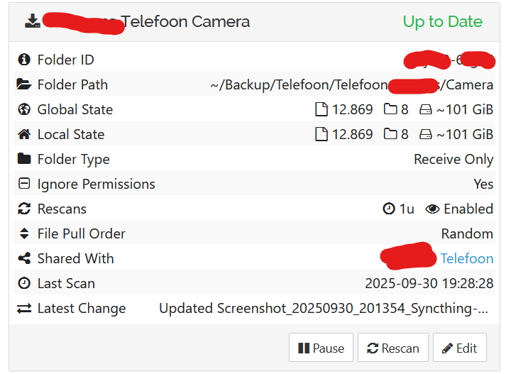

Syncthing said it couldn’t find the directory that’s supposed to be synced…
The UI on both Android and the NAS should show what the current path to be sync is, so at this point, seeing screenshots from Android and the NAS would be very helpful.
Hey,
Thank you for your response! Herewith my screenshots, hope you can help me further.
The screenshots don’t match the earlier log output…
… but in the screenshots the receiving side is saying it’s up to date, and the latest change listed is pretty recent, so it appears that it’s working just fine.
