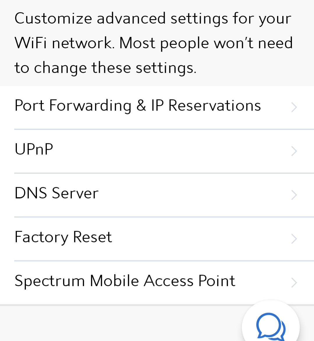

Spectrum WiFi 6 Router (sax1v1s)
Both devices are connected to the router (on the same subnet). I opened port 22000 on the router, but the devices insist on using relays to transfer data. I tried manually adding “listen addresses” in both directions, and hard-coding IP addresses into the device configurations, with no luck. Here is a sample from the log on the mac (edited for brevity and privacy):
The thing that obviously jumps out to me here is listen tcp 192.168.1.15:22000: bind: can't assign requested address – but I don’t know how to interpret it.

If your Mac is also connected to the router via Wi-Fi, check the router settings to see if it’s restricting direct connections between wireless devices. The setting might have the label “isolation”, “privacy”, or something related as such. A lot of routers include the feature as an extra level of security.
If the router isn’t restricting connections between wireless devices, then the next likely cause is a firewall on the Mac (with global discovery enabled on the Android side, it would have picked up the Mac’s IP address).
